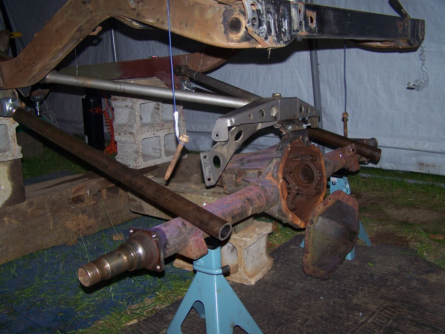

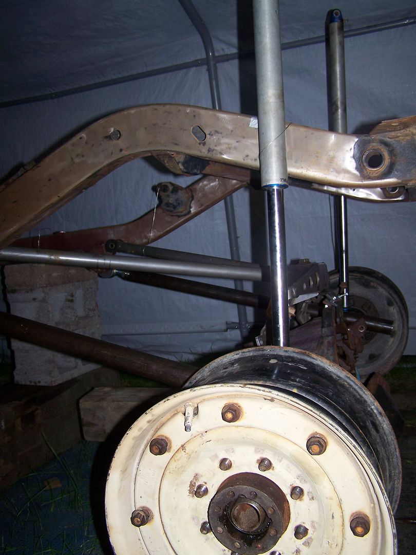

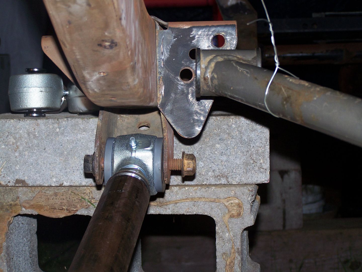

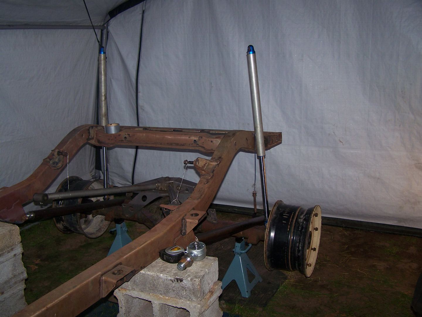

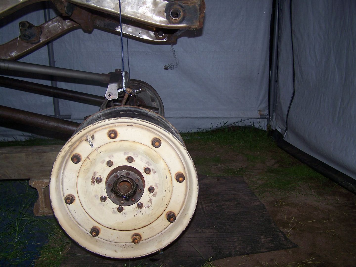

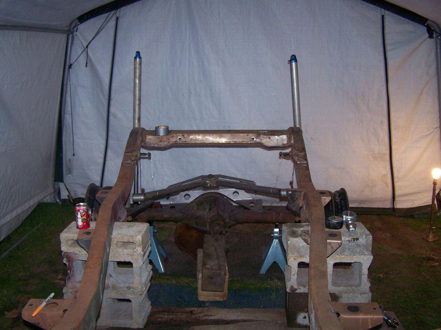

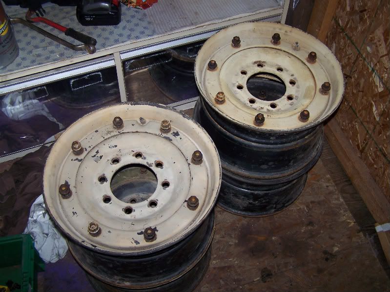

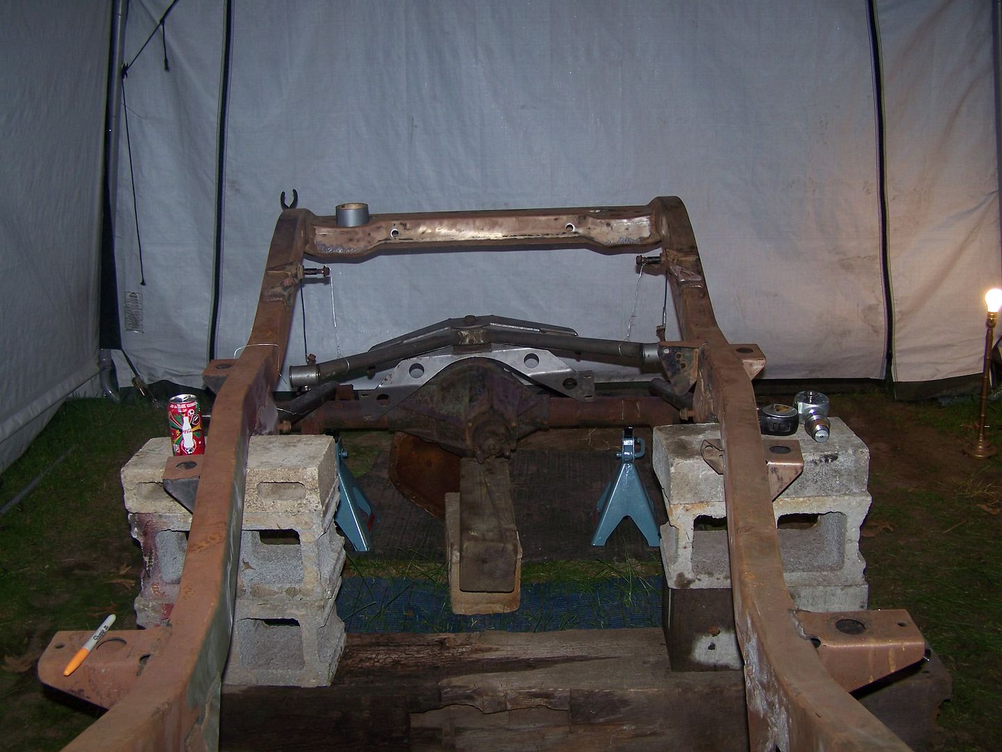

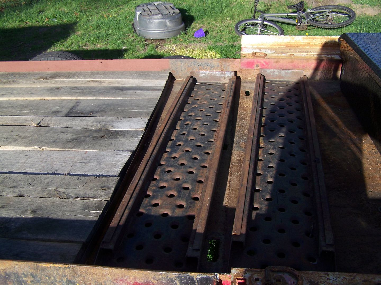

messed around with my stuff finally after a little bit. lightened up the trailer some, got my H1's (thanks to Pokerob), got 14bolt tore down ready to be blasted and shaved, got a rought idea on wheelbase, about 115", rought mock up tonight as well. :naughty: starting to look like I have started on it. :teehee:

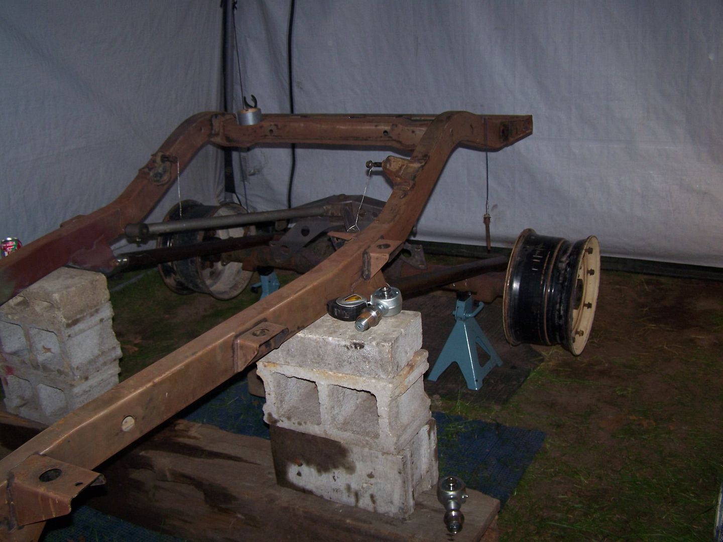

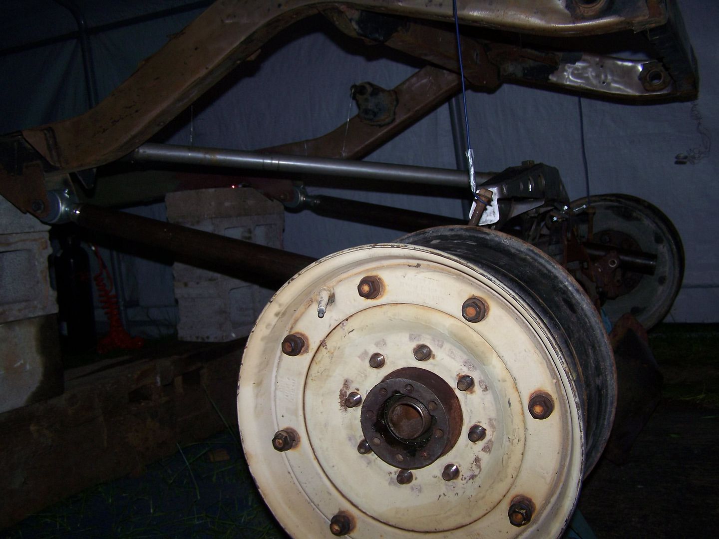

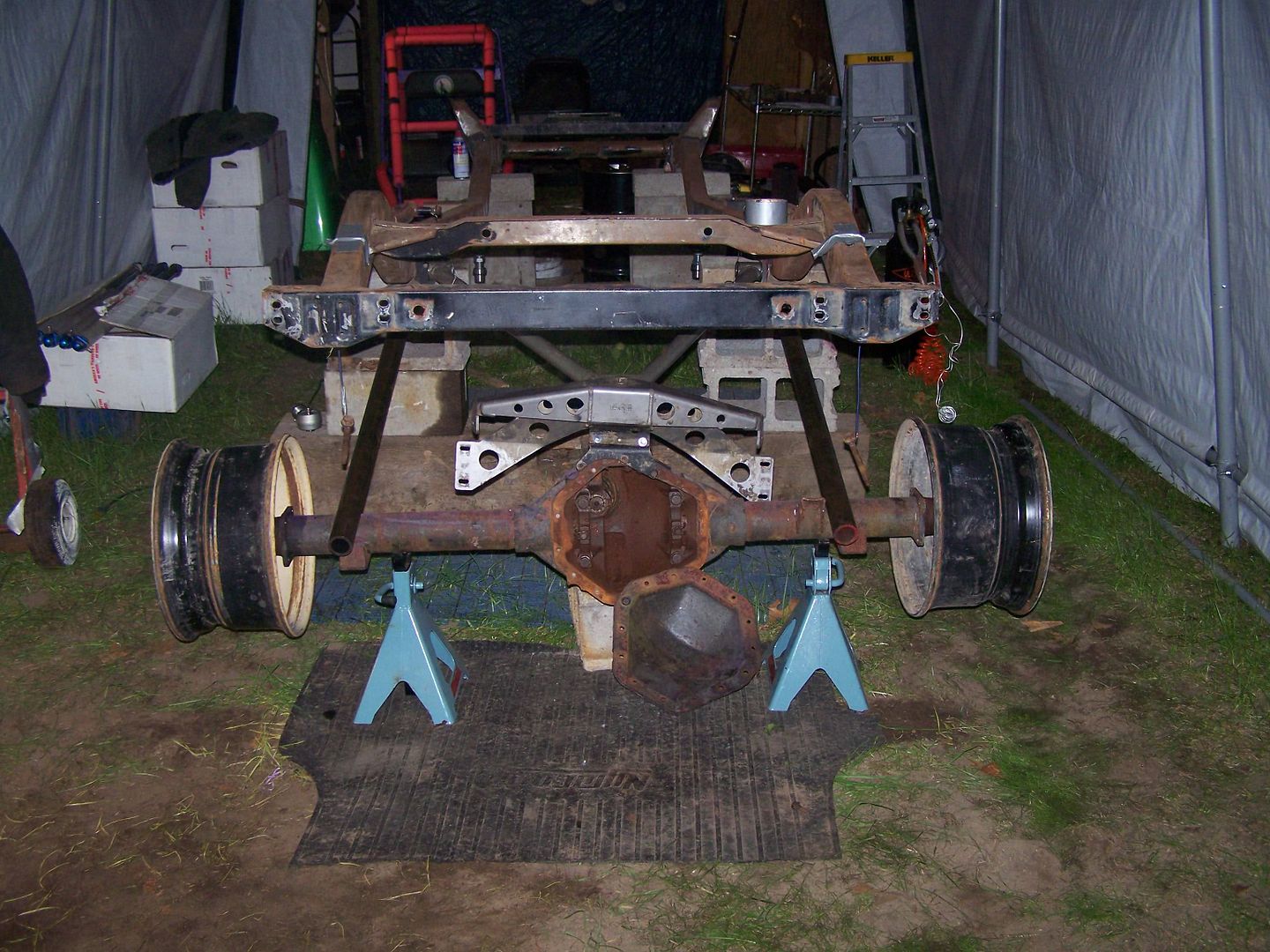

Discussion starter · #812 ·
looks like your axle is upside down :teehee:
yes it is but made it easier to mock up the tri link truss, as I will not be using the full traction truss, as it is bolt on for the TJ axle but not my 14 bolt.
looks good roger, dang that frame is clean :thumb:
Yes, yes it is :d:
Sweet Tri-Link!!! Looks like it will fit nice in that frame.
yes sir. :rock: thanks again for the stuff, will work great. Fits inside frame with 1 1/2" of space between the bushings and frame, enough room to put the nut for the bolt.

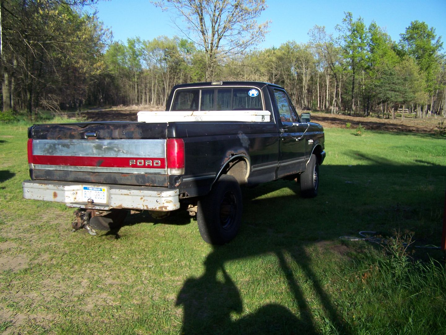

trucks not in to bad of shape good find, cuz im sure you paid next to nothing lol
Sold the dodge for 2k with the extra trans, and bought the ford for $800. :woot::woot: :teehee:
