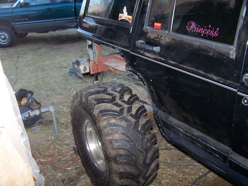

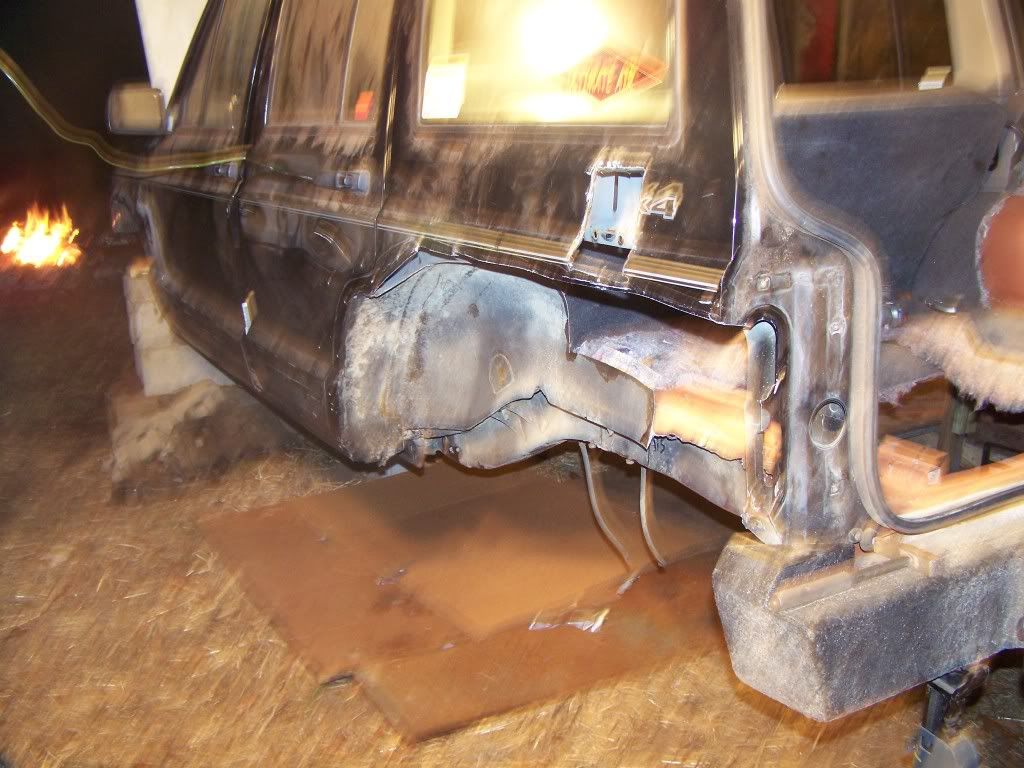

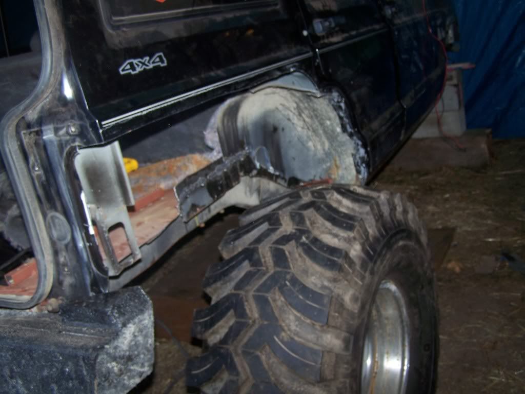

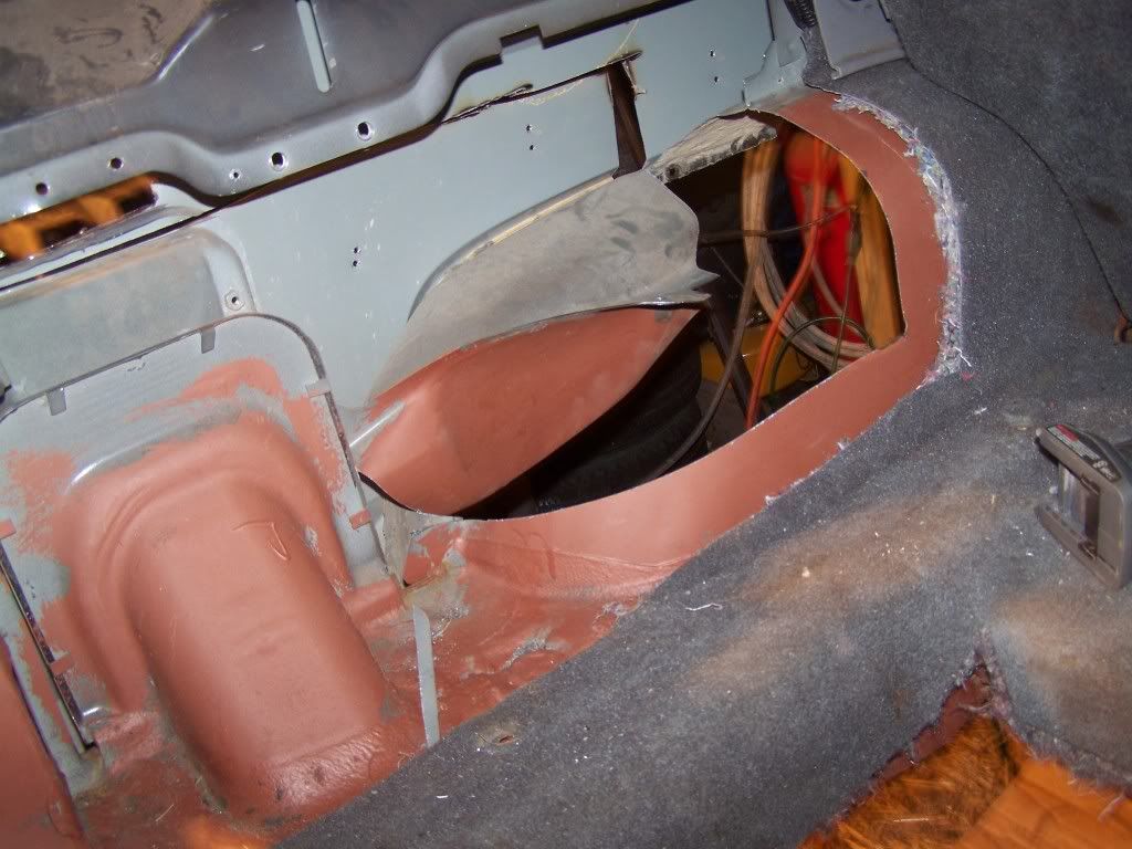

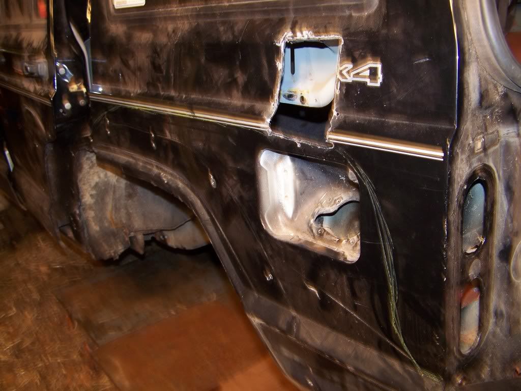

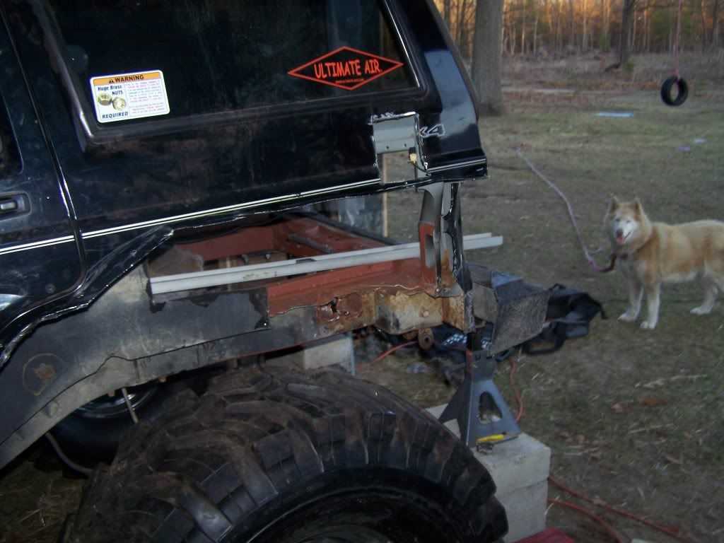

Is that a good idea with a unibody? Or are u reenforcing it somewhere?
whole frame will be plated for one with a internal cage and will be running 1" pipe along the cuts to clean it up and tie it all in. :thumb:
Discussion starter · #692 ·
Looks good. Now just bring that rear axle backwards little.
front forward 2", rear back 6-7" be around 115-116" wheelbase. Tires are about where they will be.
Discussion starter · #699 ·
you cut those out with toe nail clippers?
what the hell is it with people and shit, not like thats the final cut. besides running tube along the whole fender and tying it into the rear bumber and rock rails.
