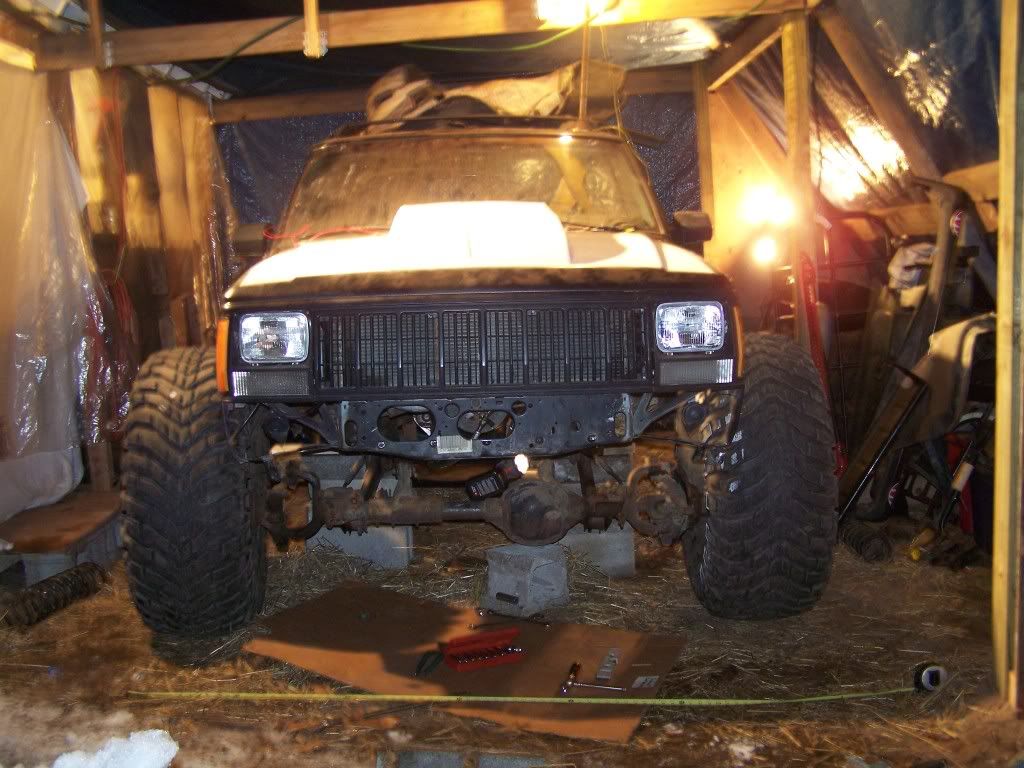

yeah, sure can, it is 2" under lift height right now and still may not go that high yet, it is set right now at about where I like it to end up.

I don't see a jack? If your talking about the cinder blocks he needs those so his "garage" wont blow away. :teehee:
Discussion starter · #469 ·
hey now, it works and stays in place and keeps the snow off the jeep. :finger:

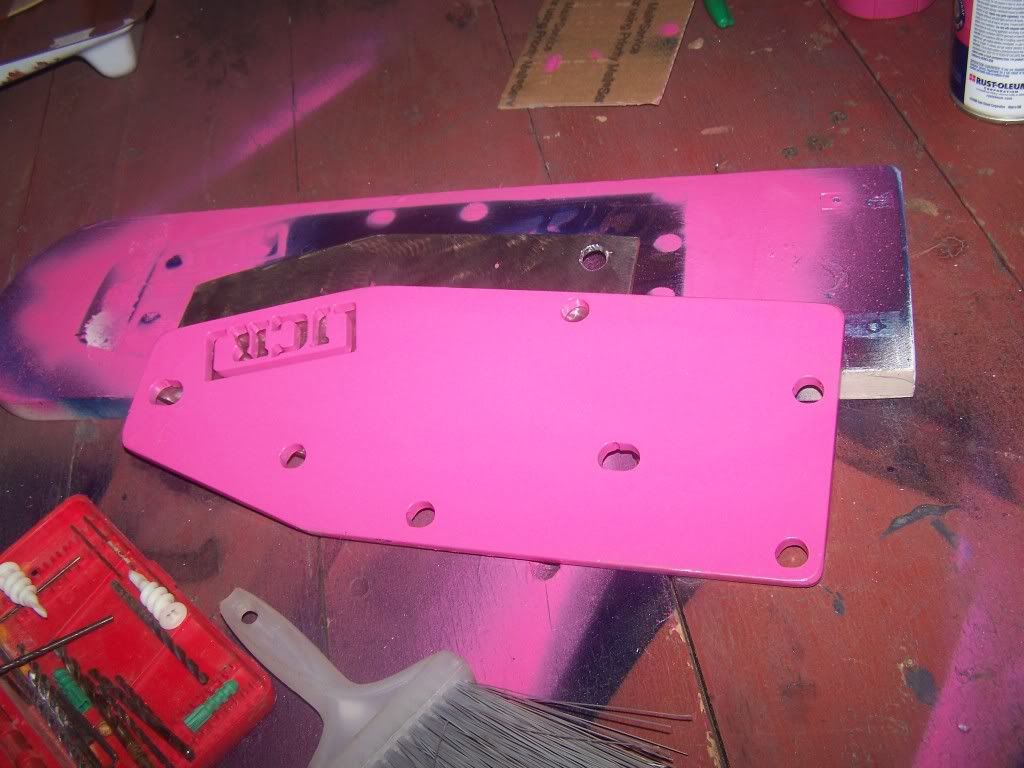

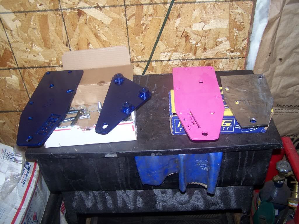

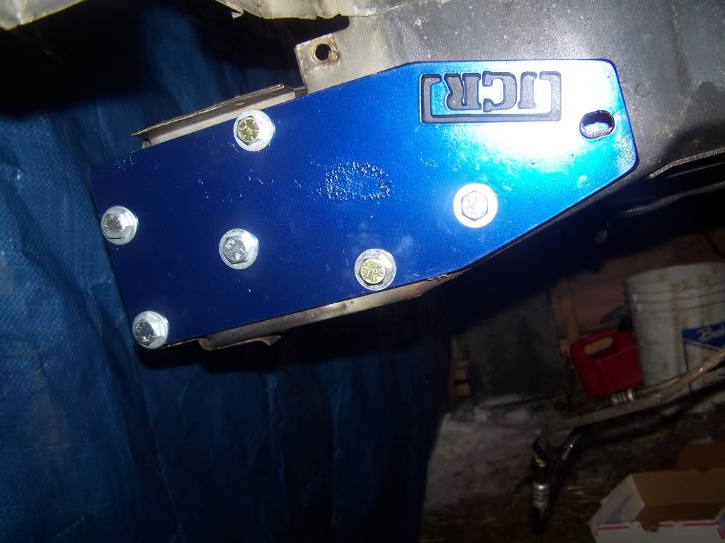

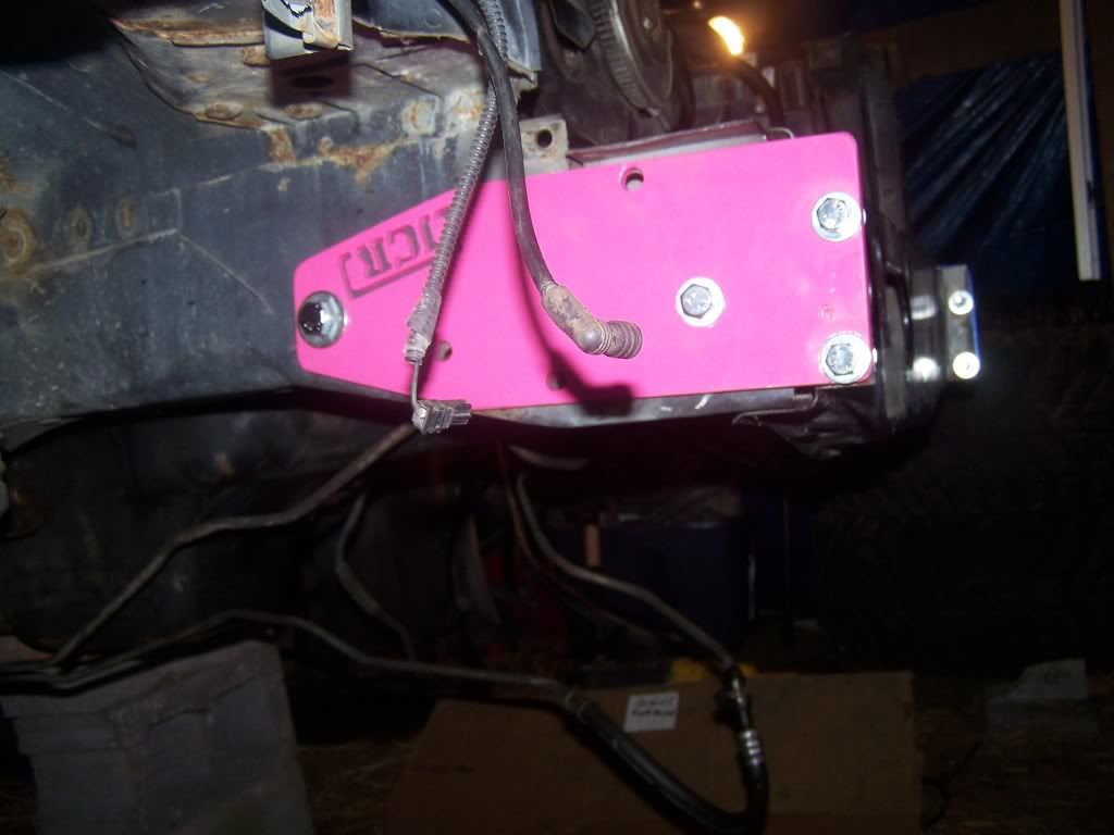

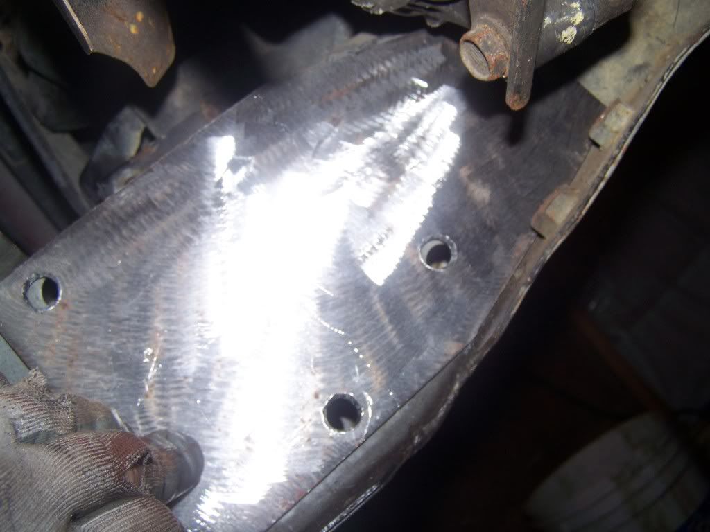

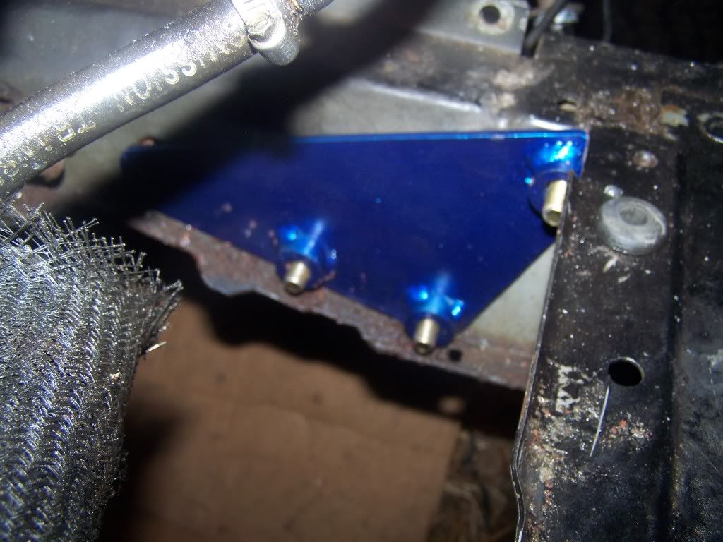

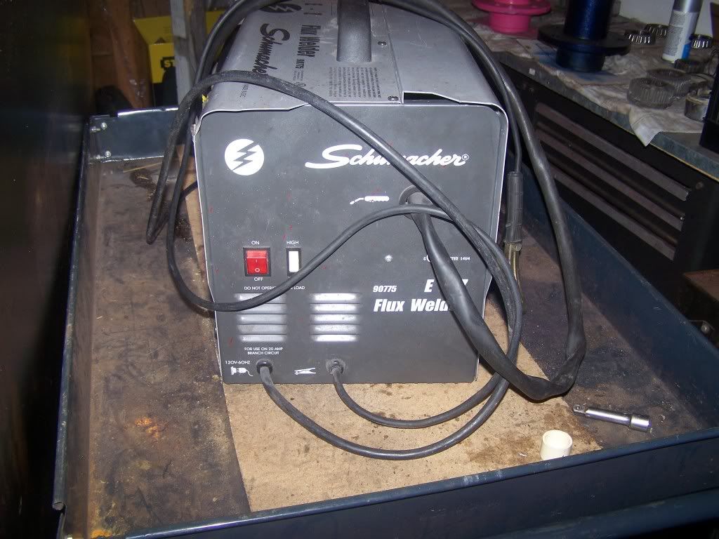

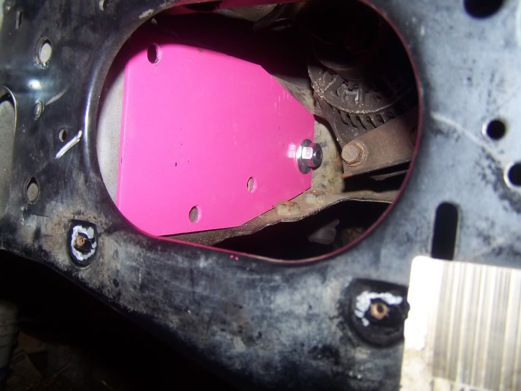

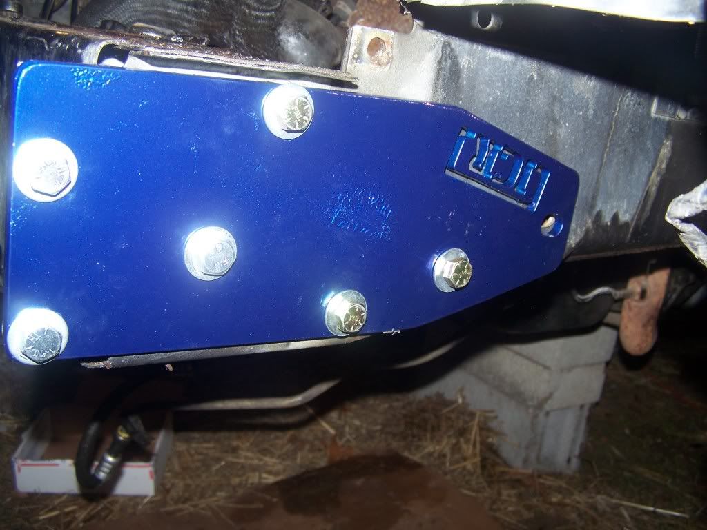

Well picked up some more parts, a lot of the little stuff here and there, then painted up the frame plates for the steering box, then once i ream the pitman arm I will install the box. I made a inside plate as well for the passenger side frame, why not right. Got 4x8 sheet of 16ga for the floors so will be working on that in the next week or so. Got everything for the inside to the knuckles for the 44, so that should be put together here over the next couple weeks,(sending it out to be done. Got me a welder finally now, so look out, my welds may not hold up but we'll see how the floors do. :teehee:
Steering braces

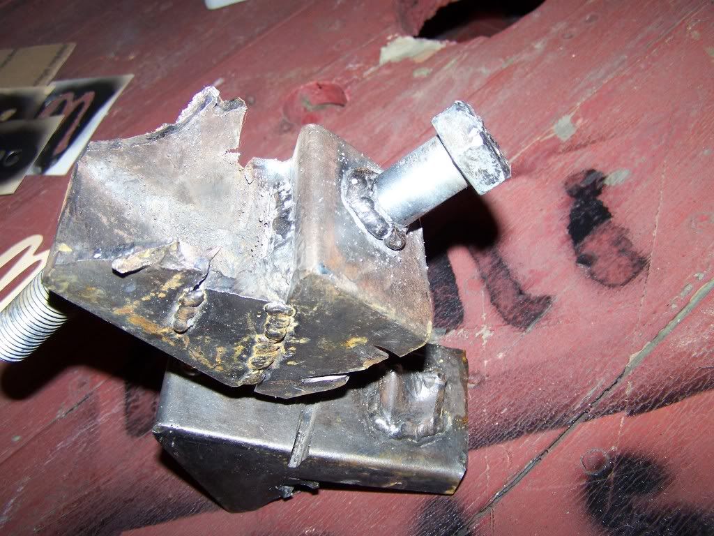

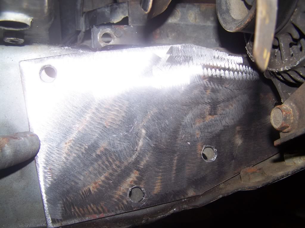

My first welding try out, not bad I think for a 110 flux core, be good for me as a beginner.

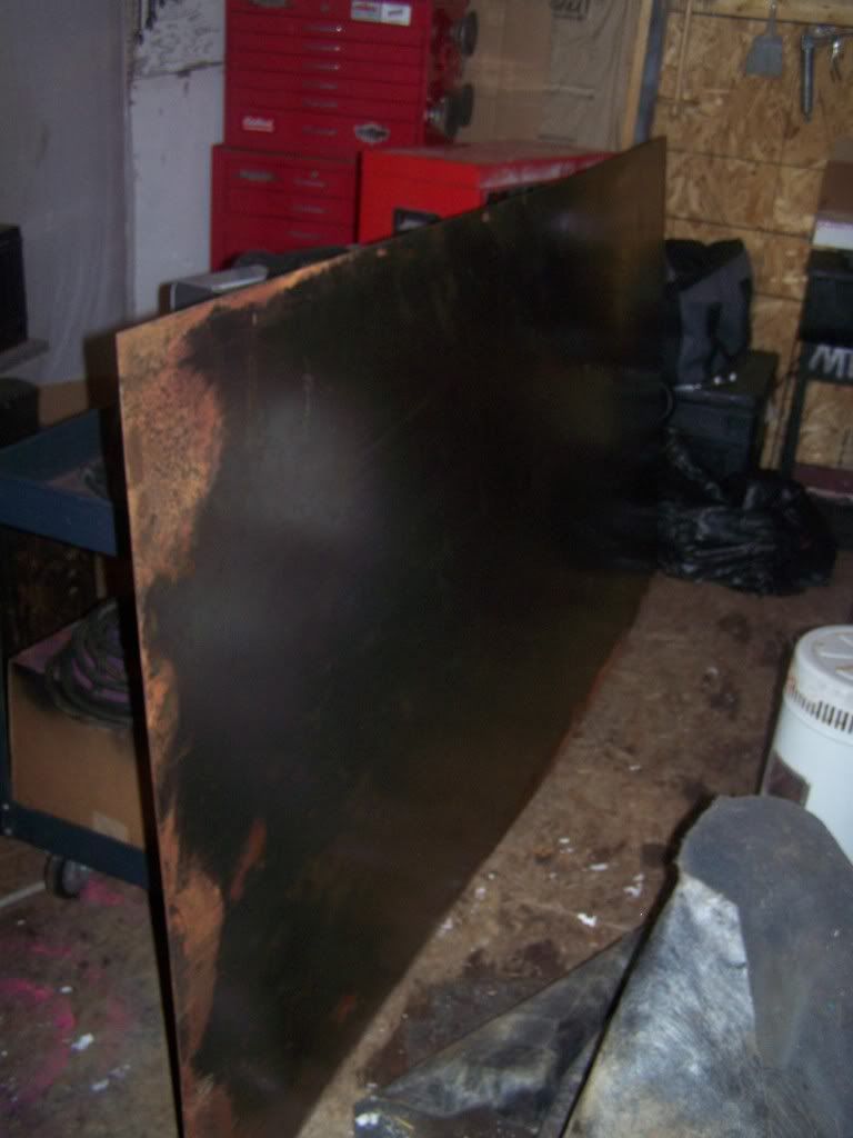

metal for floors

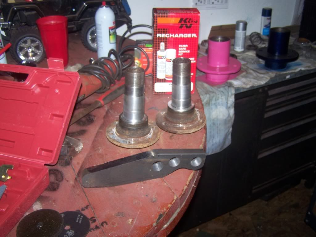

Chevy spindles turned down for Ford bearings and hubs, also high steer arm.

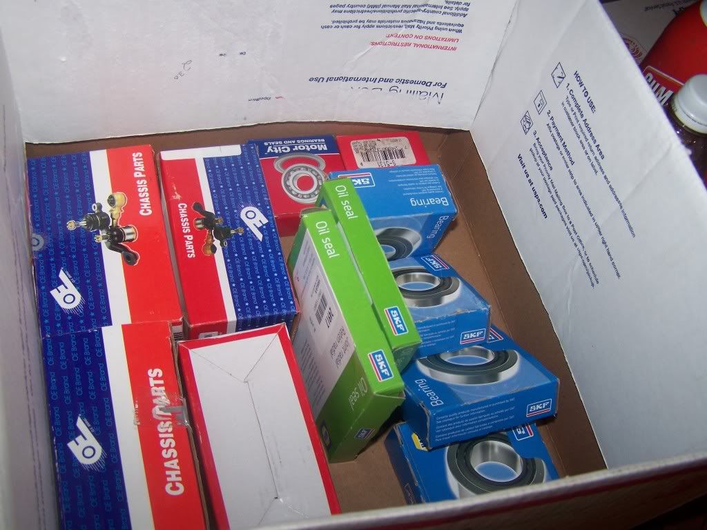

Bearings and ball joints to finish up the 44. Did not go Moogs right at the moment, as will deal with that later, just trying to work with what I got.
