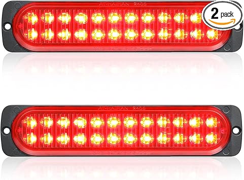

I have a cad file for the tailgate, so I'm planning on cutting that out of aluminum and using these tailights:

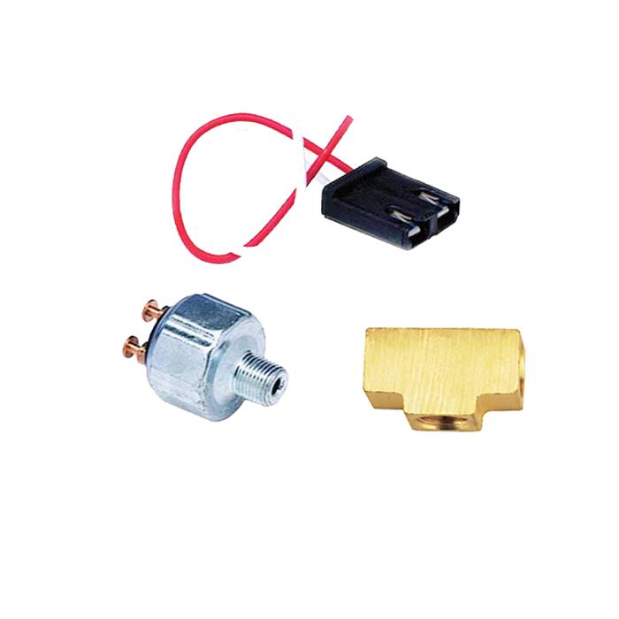

Are you running the brake lights just off that sensor you plumbed in with the brake lines? Do you just run a power in and out of the switch and the line pressure completes the circuit?
Discussion starter · #827 ·
Yep, with LED taillights the current draw is minimal, so I don't bother with a relay. I had a spare circuit in the fuse block, so I run a 5amp fuse (or maybe less) through the switch and back to the lights. No turn signals at this time, so the wiring is pretty basic with just brake and running light that I tied to headlight switch.
