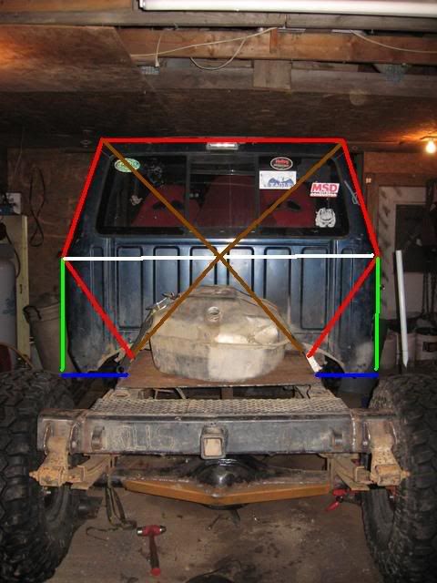

okay basically this is just the back of the cage veiw only (or "c" pillar)
each color represents a peice of pipe.
side veiw
red is exsisting c pillar
Bring the greens in the last picture toward the center of the yellows in the 2nd picture about 18" apart at the ends.....so a smaller X, saves tube and still ties them together giving you a place to mount your spare. I like, nice drawing of what we talked about, I'm impressed :thumb:
Discussion starter · #915 ·

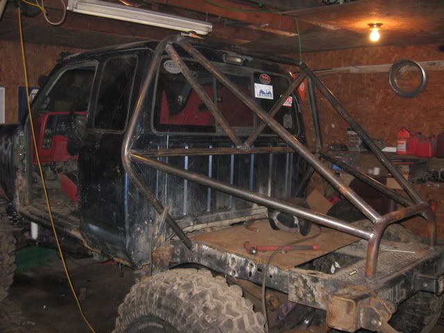

I moved the rear leaf front hangars two inches forward to get my shackle angle better. I noticed at stuff the shackles flattened out and the leafs touched the bumper. All better now.
Heres the side of the rear section of cage.
Start of the Slider
I plan to tie the cab's exo cage to the slider (reason for the slider sitting so far from the rockers
The slider didn't end up where i thought it would in the rear. One cause of the frame curved up and two cause the tire to cab clearance wouldn't allow it where i thought it would go. Heres what i think i might do at the cab corners.
Discussion starter · #917 ·
Exo is done as much as it will be before my trip to KY.....Got my jam nuts installed on my steering. Ran out of wire and gas for the welder :( Quick trip to TSC will fix that in the morning though.
nice work.
i have bent a tube or two....that shit takes a bit of time.
you work fast as hell.
looks totally sweet, i would wheel the shit outta that.
Looks good man, i would run a tube up from in front of the door with a cross over the front of the roof before the trip if you have the extra steel still
