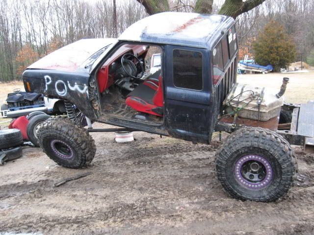

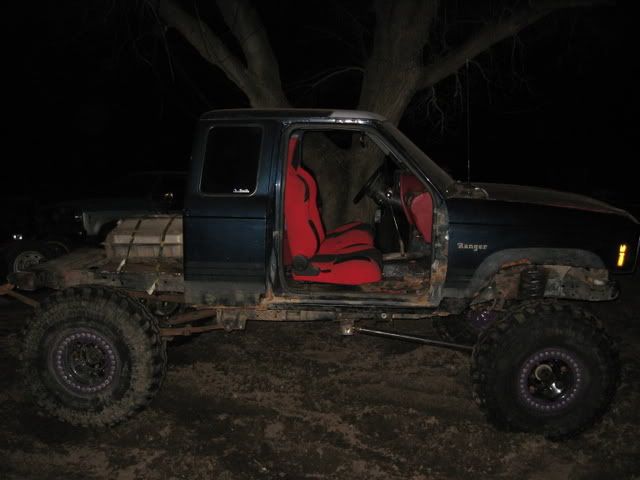

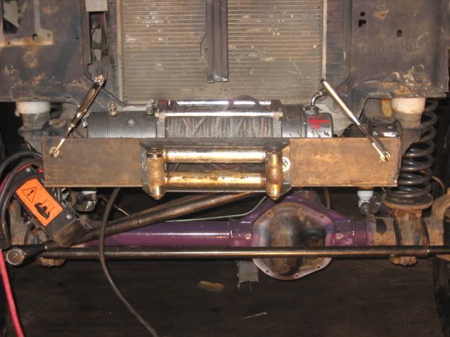

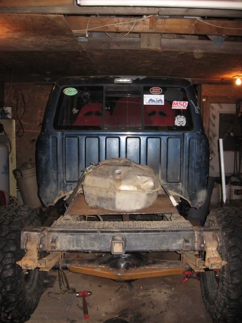

I got some stuff done....went and got my shocks, installed my tcase, made my driveshafts, worked on the front susp a little. Need to figure out what i want to do with the bed cage design and mounting of the gas tank. Have a few ideas.
Need to build the front bumper, mount winch, mount shocks, mount seats and reassemble the front axle.
Got my powersteering pump today, ended up ordering a pump from napa. Its the heavy duty option pump from a 86 FS Bronco. Just have to modify the bracket slightly for it to fit.
