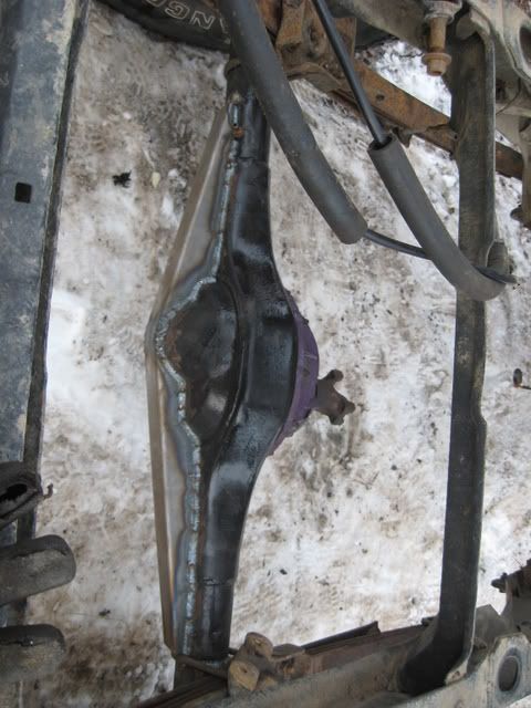

D44 HP w/3.54 open= will be shortened on the pass side with Chrome moly EB shaft

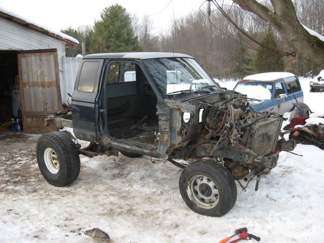

1986 B2 Frame

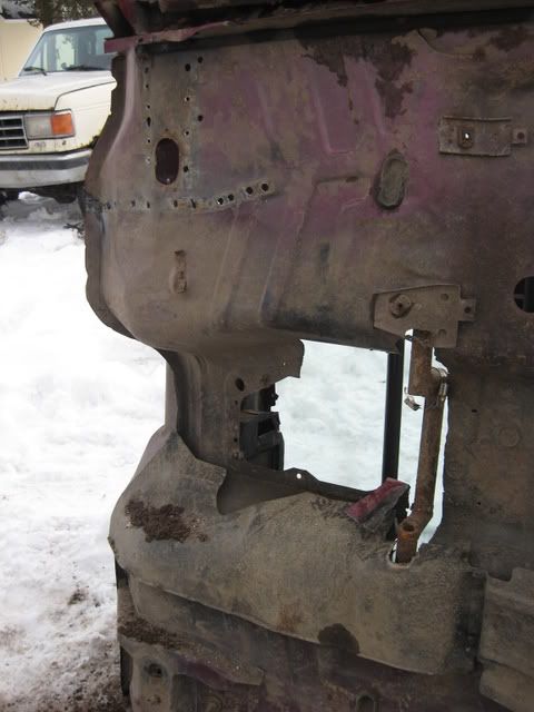

you might remember this frame from its previous life
and the 1987 B2 Body
