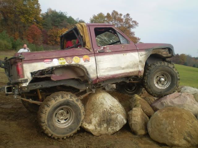

you might have seen my Ex the other day as the photo of the day with the water pouring from it with the door open
well that rig is getting retired
heres the new project
