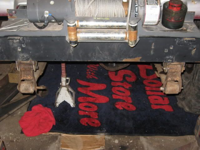

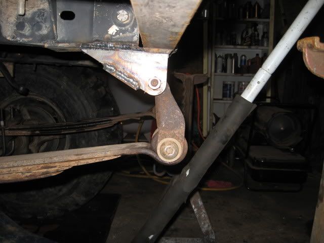

took some shots of the front susp. heres the LF at ride height
heres the Front diff at ride height, i was concerned about clearance of the diff to engine cross member
heres the diff as stuffed as i can get it in my yard,

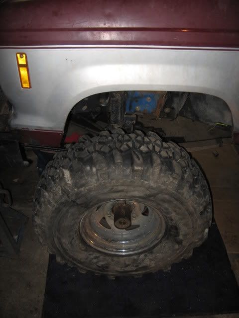

heres the fender to tire at flex, the tire just fits inside the fender without rubbing to bad
heres the droop on the RF
all pics were taken at the same time without moving the truck, i would like to get a chance to run up on an RTI ramp or similar to max test the flex. Haven't gotten the chance to do that yet.
