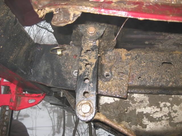

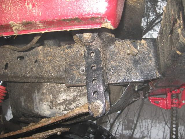

I sheared all but one bolt on each side of that shackle bracket on either side today. I used 3/8 grade 5 bolts, now they will be grade 8
i also toasted another LF axleshaft, i really need to buy some chrome moly shafts and get weaker hubs. My hubs are the ones that are all metal and indestructable. I need to get the weaker hubs and several spares that way i can just change the hubs quicker and less costly then shafts and joints each time
