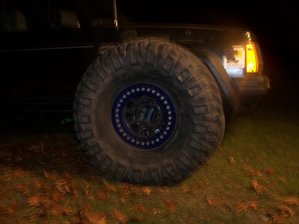

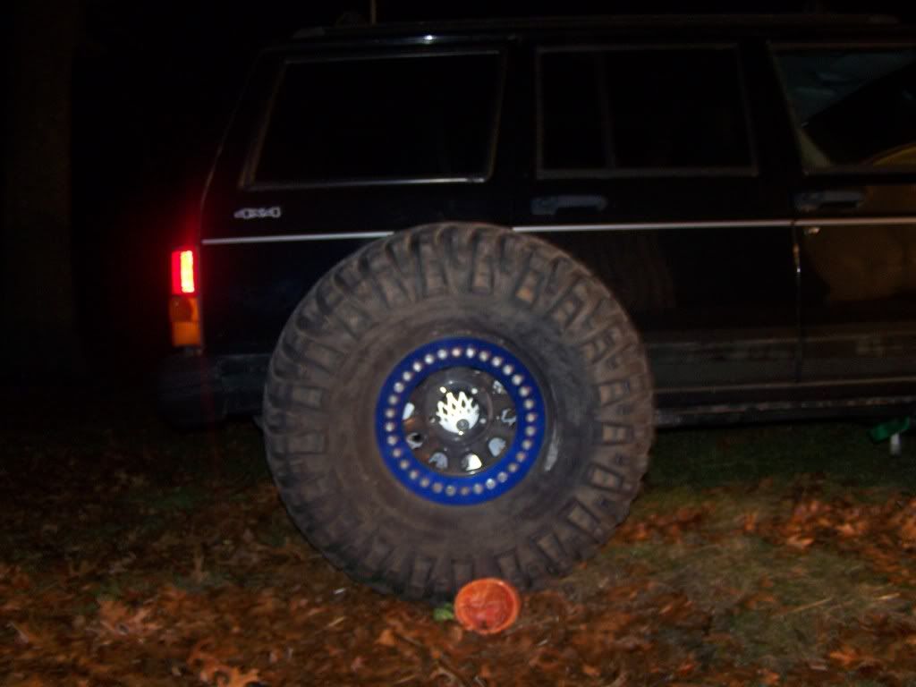

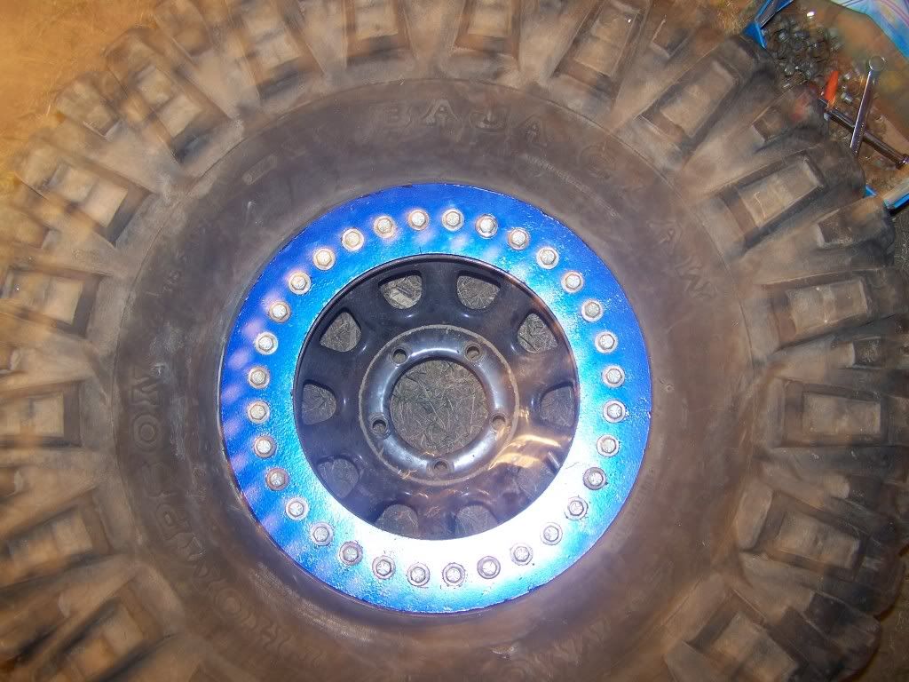

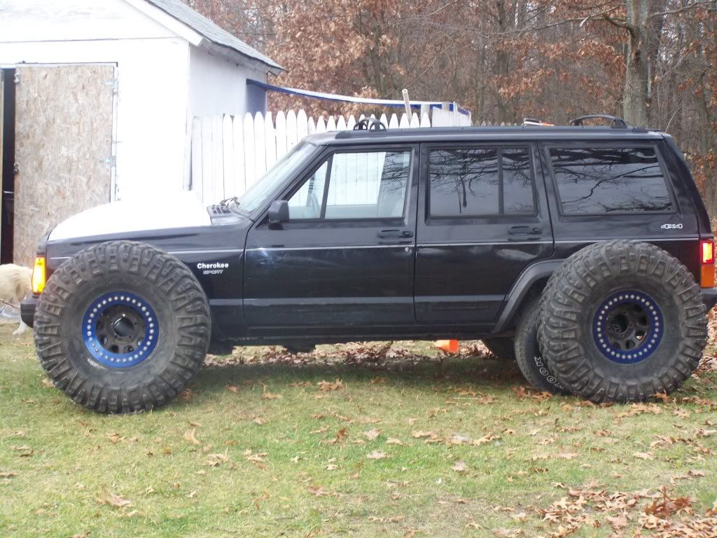

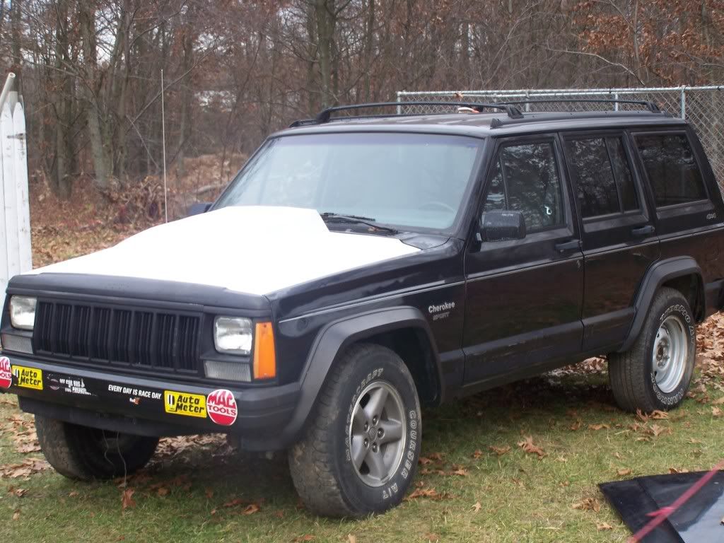

Well, thought I start my post for the XJ build. You may know me and my MJ but had to get rid of her for the XJ. More room for the kids. But Not looking back for now. So the low down is I kept my 33x9.5 tires and the heart of MiNi Beast. my 8.8 410LSD disks, so thats going under the XJ replacing the 8.25, mounting the 1 1/2" UBE and 4.5 RE springs. Front is getting 6.5" springs with the RK 3 link LA set up. The XJ is 2wd, but already has 4wd conversion started less the tranny and tcase. Which I have a AX-15/231 combo waiting to go in after the lift.

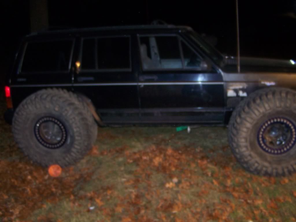

But I did at least get her up on 33's...

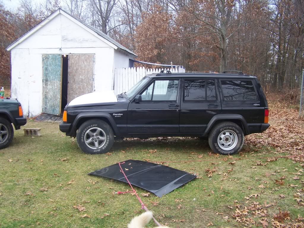

But shortly got the XJ and the MJ had to go...
So sold MJ and started collecting parts for my build...

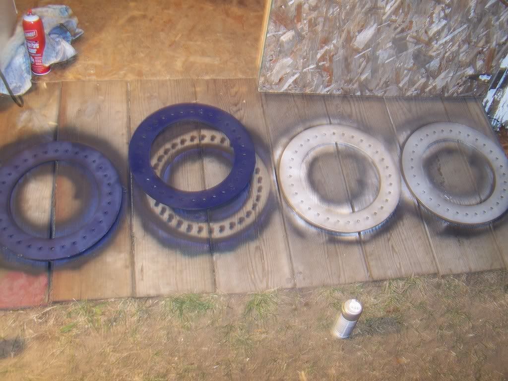

Started working on the 8.8. Taking the perches back off getting it ready for the 1 1/2" UBE. :brows: End of the week I'll be ordering the last of everything then it is on for the build up.
