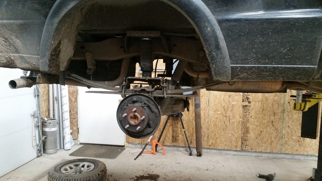

Starting to pull rear axle down. Going to Gene's auto in TC tomorrow to grab the transfer case shift linkage and an 8.8 with correct 4.10's and a posi from an FX4 ranger they have there.
See less See more
First time I've dropped an axle from a 17 year old truck where no torch was needed :woot:

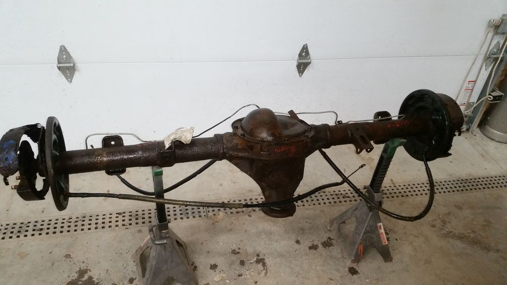

Bad part is that I now find this truck has 3.73s reading the axle tag. I was 99% sure it had 4.10's as I ran the math on mph/rpm/tire size/trans ratio. So apparently either the speedo or tach is rather off. Since my rear end is a time bomb regardless, the question is; do go the cheap route for the moment and get a 3.73 8.8" and put a lock right in it down the road? Or buy a 4.10 8.8" that has a factory limited slip and a 4.10 front end to match? By the time I buy the lock right, I'm at the same cost in the end, which is more than I was planning on spending tomorrow LOL. No matter what I need to go to Gene's for the t case shift linkage and floorplate, so I figure I'll bring my rear end and try to talk deal in person.
Since I'm building this truck for towing/hauling, I know the 4.10s will make more sense in the long run and with 31's will put me at [email protected] in 5th. That's perfect for the tdi empty cruising and 3krpm @68mph in 4th for any grades with car on a trailer. Decisions, decisions.....

My 08 had 3.73's, a manual trans and 265/75r16's. It didn't bother me. I didn't tow too much with it but the few times I did (once from Detroit to SL and back) I had no problems. I never came close to my towing max and I left it in 4th for part of that SL trip. Mine also had a 4.0L so power was 208hp and 238ft/lbs
I would keep the 3.73's. Keep in mind when you order the locker or limited slip that the 8.8 came with two different splines. A 28 spline (what I had with factory ls) and a 31 spline.
with the added torque from the tdi, I would stick with the 3.73s. I ran 3.54s in my old 12v cummins. Guess it really depends on end tire size as well...

That was a lovely trip to Gene's. Guy on phone claimed up and down they had a manual t case 4.0L ranger out in the yard that I needed the shift linkage from. Turns out it was an electric shift manual trans truck :mad:. Now rather pissed I just drove 1.25 hours each way for nothing, we talked on some axles. They didn't have a 4.10 front to go with a 4.10 posi rear, so we settled on a 3.73 8.8" rear end for $170. Even got them to pressure wash it for me! It's only the 28 spline, but I'm sure it will be fine for my uses. I'll put a locker of some kind in it later. Going to hit it with wire wheel, paint, new seals, and transfer all my good brake hardware over.

After wire some wheeling and brush on rustoleum, the pig now has some lipstick!

You should be fine with that 28 spline. They're both strong.
Good to hear. It will never see larger than 31s or crazy wheeling. Mostly hauling loads of wood and dragging around broken vw's :sonicjay:.
Got the axle in the morning. Test drive was great; no more clack-clack-clack between shifts in the lower gears :rock:.
