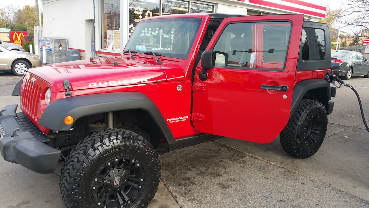

2008 JK Unlimited Rubicon.
When I purchased it the previous owner had installed a 1" Body lift and was running 33x10.50 Trail Grappler MT's wrapped around KMC XD Series 2 Wheels. Stock spare tire and wheel though, blech
Came with the Dual Top package, Hard Top and Sunrider Softtop, unfortunately had one torn up window, but easily remedied.
80K miles, ran good, no leaks, a few little rust spots on the body, but nothing but a little surface rust.

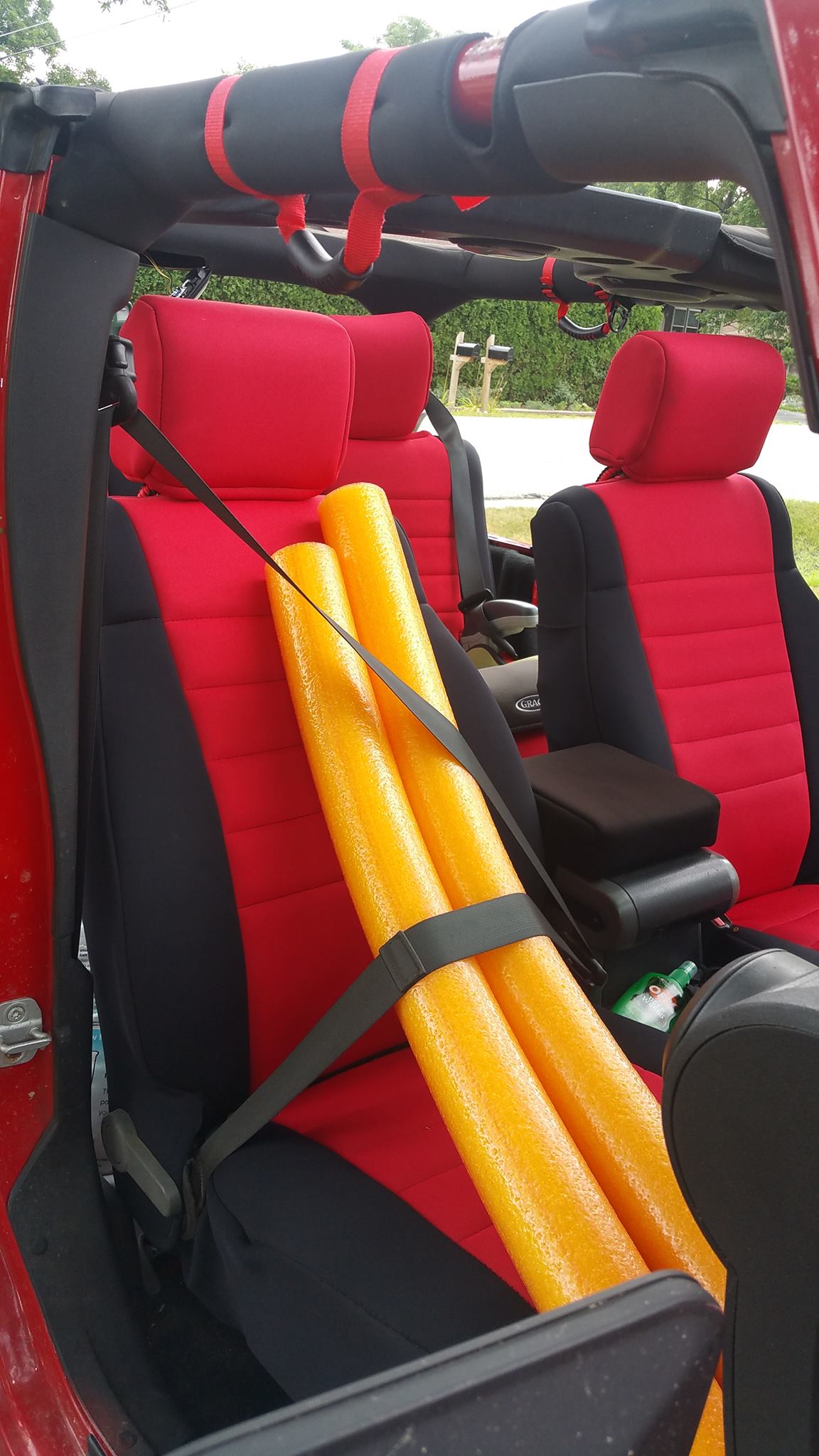

It was also getting colder, and having been used to my Grand Cherokees and heated seats was already tired of having a cold bum.
After looking at options etc I ordered a set of Wet Okole seat coves with the carbon fiber heating pads installed.
I got them in Red and Black, heating pads, lumbar support and sunglass pockets.
Been super happy with this purchase, easily one of the best things I did.
Covered up the stock Grey fabric seats and gave the Jeep a custom look, and are hella functional.

I went with 37x12.50 Mastercraft Courser MT
Granted I've only had a week with them, but was quite happy on road, on the dunes, and running muddy 2 tracks in the forest.
And bought another Wheel to match what was on it.
I have a set of used Inner airlocks waiting to go in, but the way the wheels are constructed i'm not sure I can get the second valve stem in. When I have a chance i'm going to break my spare down and see. I want to get at least a manual tire changer first to make the process easier though then i'll work on that.
Everything works and fits well, only rub was on the frame/ lower control arm at full lock. Turned out the steering stops a touch and nota problem anymore.
So that's 37x12.50 with Flat fenders, 1" Body Lift, and 1" Leveling Kit.
