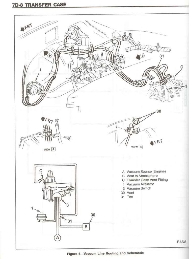

My 97 s10 4wheel drive just recently stopped working so i replace the vacuum actuator on the trans and now it still isnt working. I can hear clicking under the dash when i push the button like its wanting to engage but wont. Han anyone else had this problem? Thanks in advance.

thats the diagram for the actuator.
