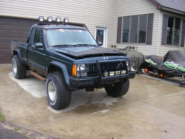

so ive been on here for a while and decieded it was time to start my build..i picked this up 2 years ago for 700 and started working on it.. i got it running and started from there.. heres a few pics from when i got it.. it has a black diamond lift and on 33x12.5 at
youll notice the brush guard missing yeah first time i got it stuck and realized i had no tow points.. as you can see the brush guard didnt last.. well one night sitting at home drinking decided i wanted a different color so taped it off and rolled it on.. yes rolled..lol

ive added a 2" spacer \ shackle lift, rough country 9000 shocks and braided lines. also a JKS track bar and motion offroad 1 ton steering. also a new set of wild country mtx's
started working on it this summer i found some rust free doors from an 86 mj so i modded the hinges to have lift off doors and fixed the floor boards and cut the flares off..
heres the back plates shaved down
rusty floors
flint stone time..lol
all welded up
