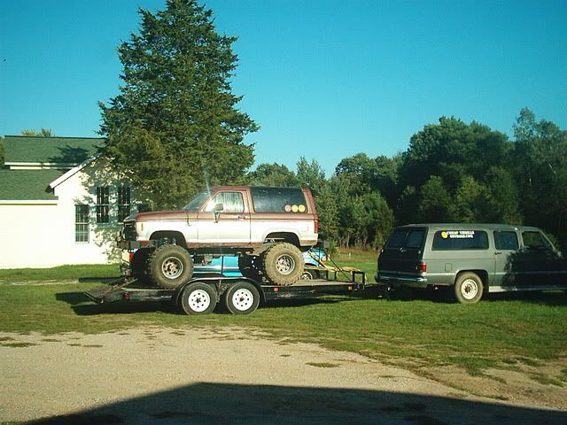

Discussion starter · #179 · (Edited)
Pig Gig 2007
she did pretty well, better then my explorer
pretty happy with the build, just gonna make a few small changes here and there
first time ever in the mud
oops
and when i got it home
