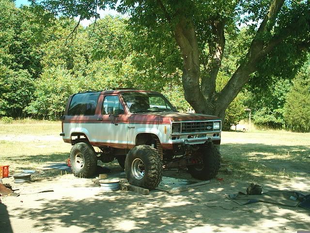

Got my rear brake line ran, got the fuel lines run, radius arms and trans crossmember finished for now (i'm sure i'll change it again later)
the Steering is set-up,
i still need a gas tank, front carrier (3.90+) axle shafts, need to shorten the frt driveshaft, and get my wheel adapters for the rear and a lot of other loose ends to tie/buy up

trying to have it ready for the pig gig, but i forecast runing out of money before then and won't have it finished, but damn it i'm trying, and i hope to have the body back on this saturday

yeah i was gonna wait till saturday to put the body on.......i just can't wait to get the rear tires on with the wheel spacers to see how it really looks

its bowed from abuse and the coil mount on axle is a little off..........i'm redoing the coil mounts a little different (not happy with what i did and going to do it different)
