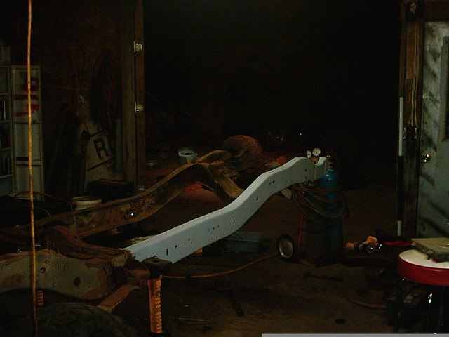

frame is painted, starting to do final mock up of the axle and getting the susp squared away
i alos got the top end of my motor torn down and will be reassm. this weekend and getting that on the frame
