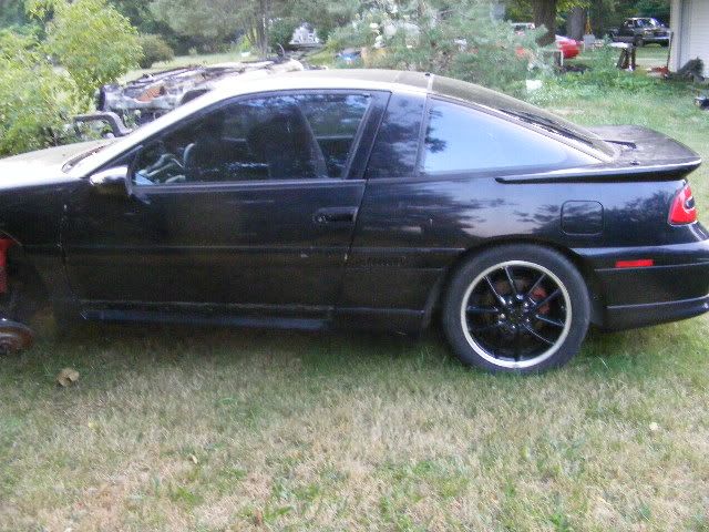

when i first bought it.

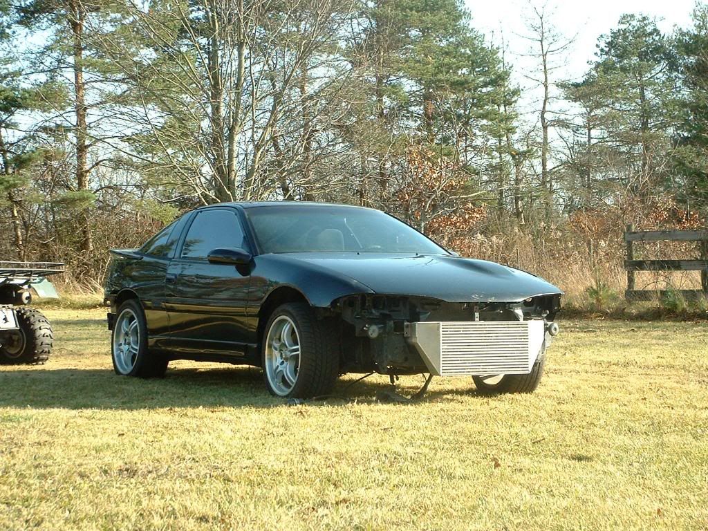

the way it sits at this moment

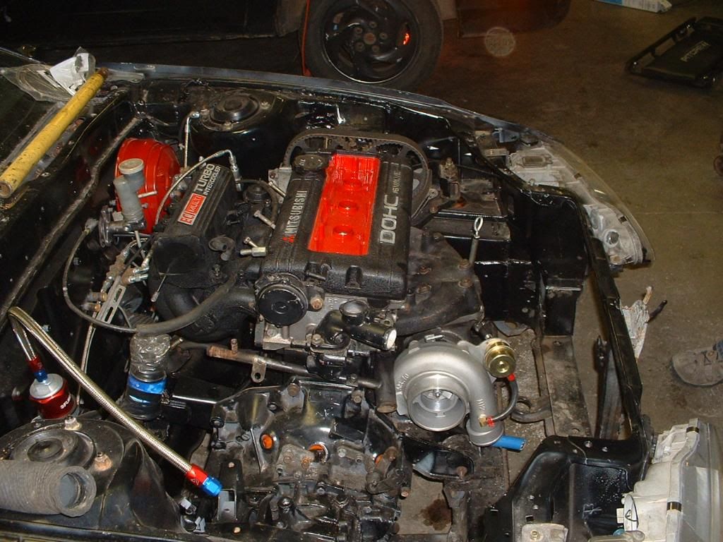

heres a shot after i got done painting the engine bay
another engine bay pics
