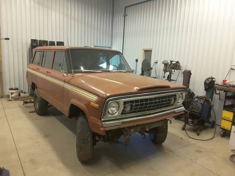

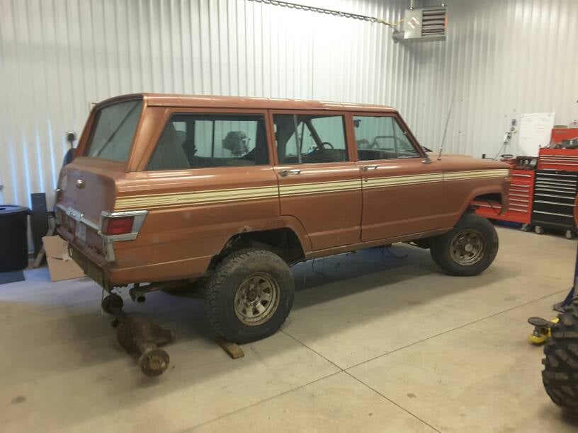

One year on the trip out to Hammers we stopped for gas at 4am near Effingham, Illinois. Jim and I were in the store looking for coffee and breakfast. Being the health conscience types we are, we decided donuts were the preferred choice. We looked at the donuts on hand and they looked like they weren't good when put out, and that looked to be a few days ago. I asked the lady behind the counter where to get some good donuts and she said the Walmart.
When we hopped in the truck we started towards the Walmart, I was asked why I'd go to Walmart for donuts. I said "the lady inside said they had the best in town, and she was neither skinny nor pretty, so I'll take her word that she knows where to find a good donut."
Turns out, she was wrong... they were crappy donuts. But "Neither Skinny Nor Pretty" stuck around and that was the nickname of the old jeep for a while.
