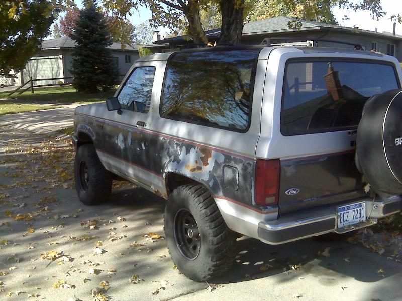

I hope not to bore you but this is my newest project,nothing over the top just a nice daily driver I can pretty much wheel where ever I want within reason.Some of this is old news but I figured I put it all in one new post so others can follow along,seems there are a few other Bronco2 owners on here also.
I picked up this 90 Bronco2 back around Oct for 300.00 for a parts truck.I was told it had a broken flywheel and other small issues but had a James Duff stage 3 lift I could use on my 84 B2 so I bought it. When I picked it up I was happy to see it was in way better shape than my 84.
My 84.
This is what it looked like the day I brought it home.I took the wheels off the 84 and sold it for 900.00
Within 48 hrs I had found out the gas tank had a rust hole,4wd didnt work,starter was falling out from a stripped bellhousing{flywheel wasnt broken},trans was a fresh rebuild,valvecovers were pissing,shocks were junk,powersteering pump was leaking and all brake hoses and lines were bad.
The next week was spent fixing the gas tank,starter,oil leaks,swapped new wheels and tires on,installed Belltech 2" shackles to level rear and cleaned the piss out of it.Turns out the truck was in great shape other than some minor rust.
At this point I started daily driving it taking on the other small problems as I went.
