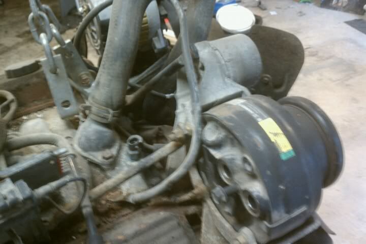

so i had my 88 chevy 350 rebuilt and i didnt take any pictures along the way. i dont remember where all the accessory brackets went. does anyone have detailed pictures of all the brackets. it would really help me out because im at a loss with it

I was just thinking about the pattern you have. it should have the large Horseshoe style mount that wraps around the water pump. has the alt & tensioner up high. the p/s is down low on the left. the a/c mounts high on the right. should have 2-3 pencil braces back to the intake from the a/c & the tensioner center bolt. the alt should have one. the p/s has a brace that goes onto the exhaust stud at the front of the manifold.
the lowest bolts on the horseshoe on the lower right take the ground to the frame, use a cleated washer to make sure its hooked up. if you by chance have an air pump that goes on the lower right of the water pump.
I have one sitting in my garage - if you send me a pm later to remind me, I'll be happy to take a photo and post it when I get home. :thumb:

Thanks that will help
