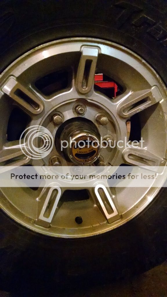

I think I might keep my new gf around for a while. Not only is the sex great but she buys me Jeep parts! I took her to Drummond Island a couple weeks ago and blew a lockout while I was there and she said she felt bad because I had just finished the axles... So she decided to buy me Warn premium lockouts. Win.

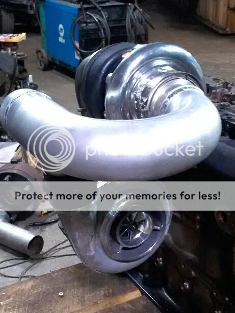

Also side track from my build, this is the new turbo set up my cousin Zak is working on for his 24v.
