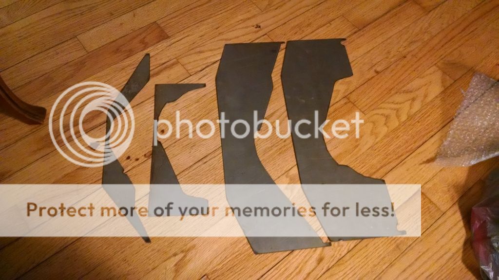

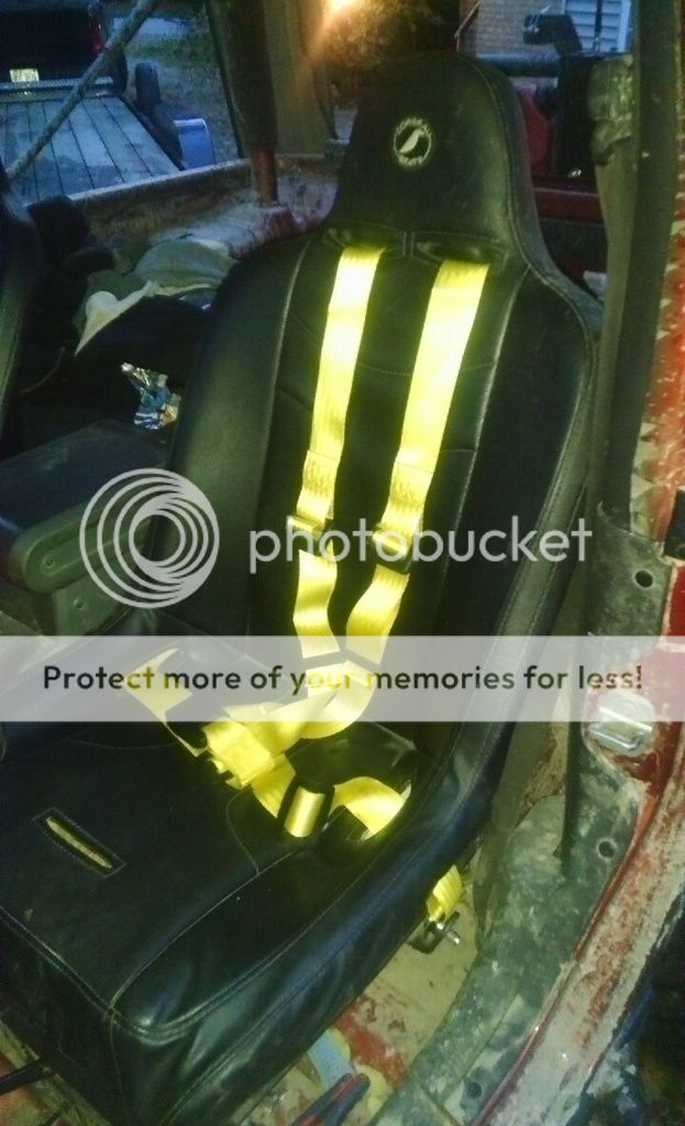

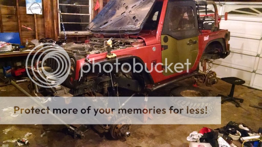

Got my 4pt harnesses installed...Takes a little getting used to because of how well they hold you down vs a standard belt. Also started tearing the front half apart so I can install an OR Fab cage that I picked up from my buddy for $100.

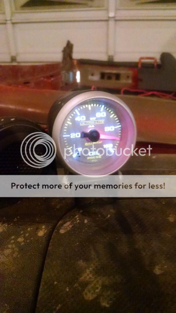

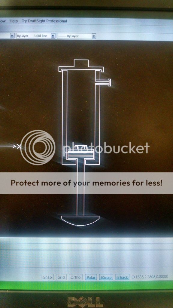

Finally got my oil pressure gage backlight wired up so I can see it at night. Also, after talking with my roommate, we're both going to give a shot at building our own air bumps. We'll see how it turns out.

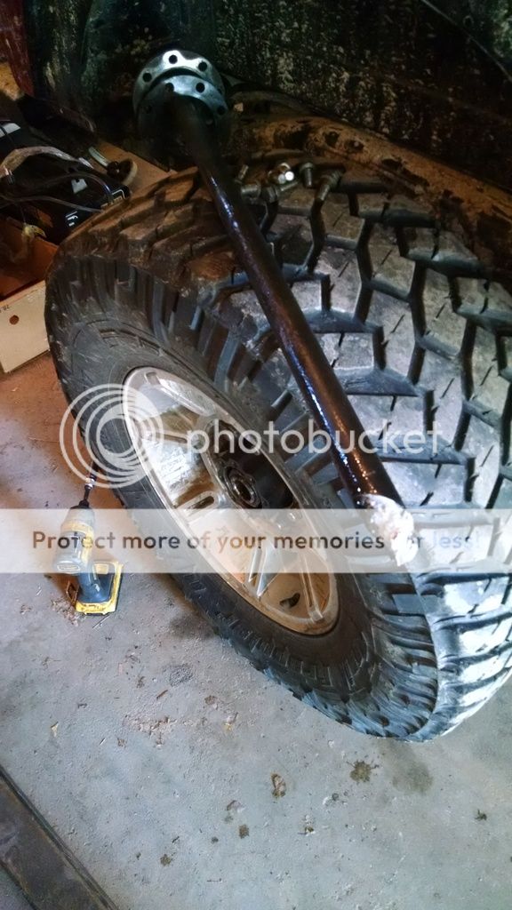

Snapped a shaft on my 60 already while "pulling out of the garage"

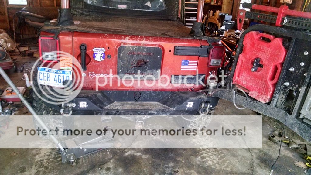

Pic from up at Drummond Island of only my LED cubes in my rear bumper turned on.

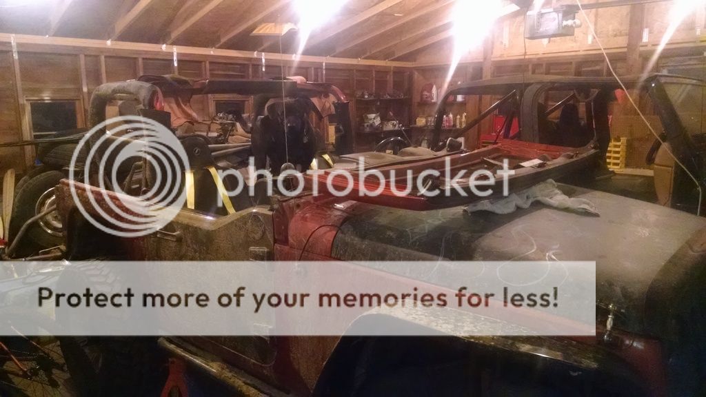

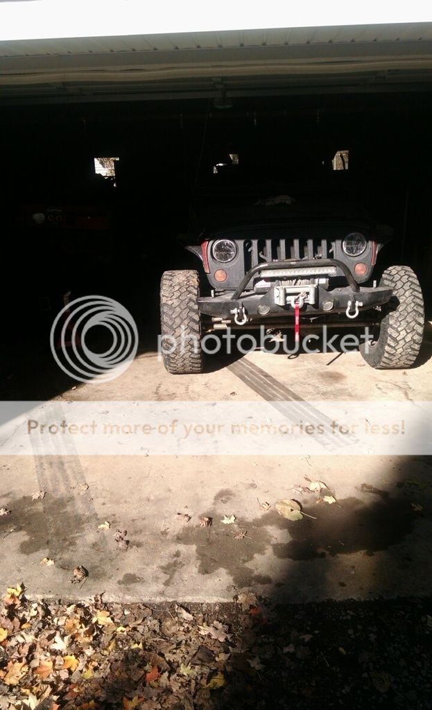

Random garage pic.
You can even see where I was pulling out of the garage when I snapped a shaft... :rock:
