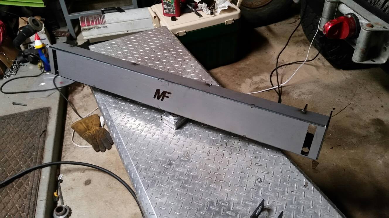

Picked up my frame chop bumper from laser today along with my roll cage body tie-ins. Got it all bent and tacked together, just have to finish cutting my frame tomorrow and test fit. Also started looking into parts for my 60. Really want a selectable locker but I don't know if money will allow in the time frame I'm shooting for.

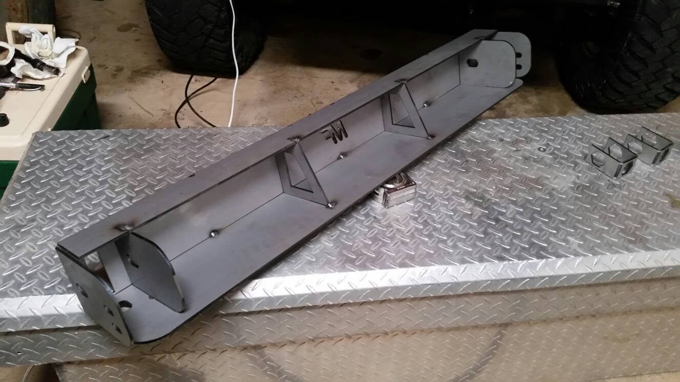

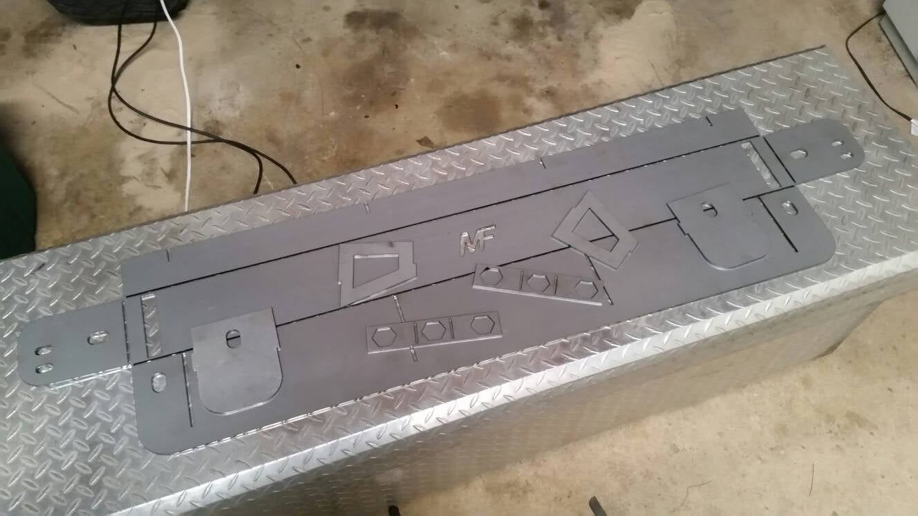

Everything is one faceplate with relief cuts to bend along and then gussets and inner frame mounts keyed into the bumper. Also made nut strips for inside the frame rails

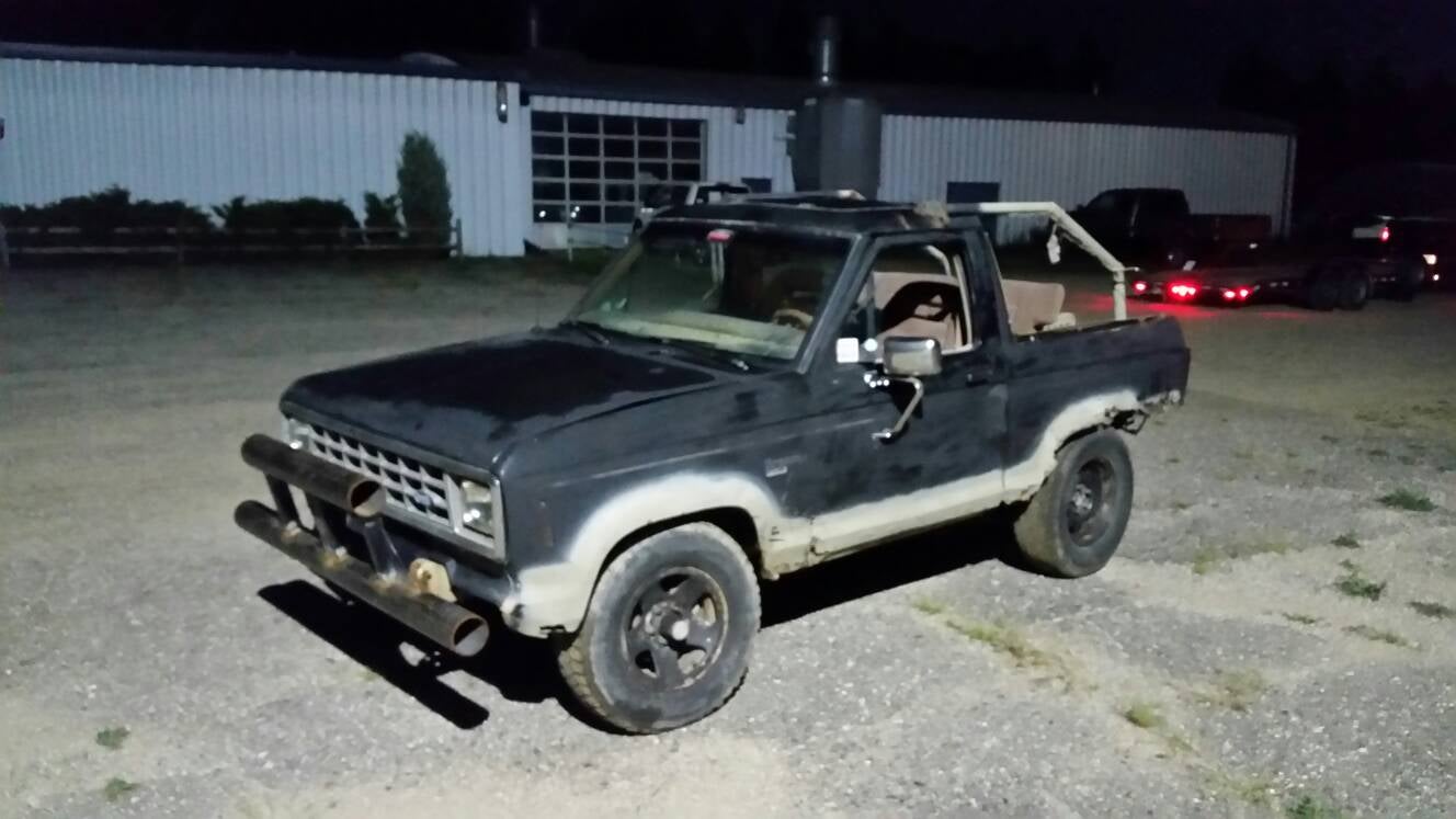

I wouldn't trust the roll cage for shit. Lol previous owner basically welded angle iron from tubing to the roof
