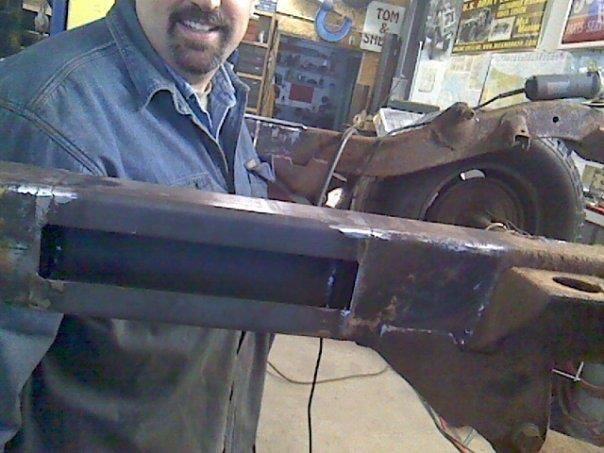

well i figured my rig is pretty unique so i decided to do a build tread
its basically a wrangler frame stretched 10 inches in the middle and out the back with a scrambler tub and yj drivetrain and electronics
frame stretch
initial mock up
the motor is a 95 2.5L with (in this pic ax5) dana 30/35 with posi
we went with a 4 inch spring in the front and spring over in the back
