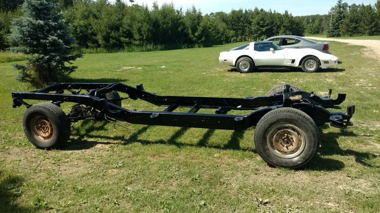

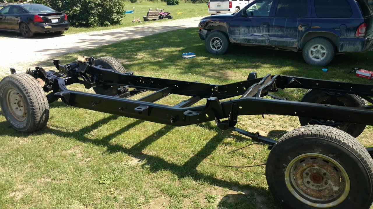

Haven't had a chance to get many more pics, but these little teasers were sent to me a bit ago. The donor frame was wire wheeled and cleaned up, then painted with TSC implement paint. Looks a million times better than the frame on my truck.
The truck should be done with the frame swap today or tomorrow. I'll take some more pics when I bring it back home. I still have to put my bed back on; bolt up the rear bumper, and put on some new tires. Got all new body mounts, body mount bolts (2 of the ones in the truck were broken from when I put in the body lift on the cab), fuel lines, brake lines, and fuel filter.
