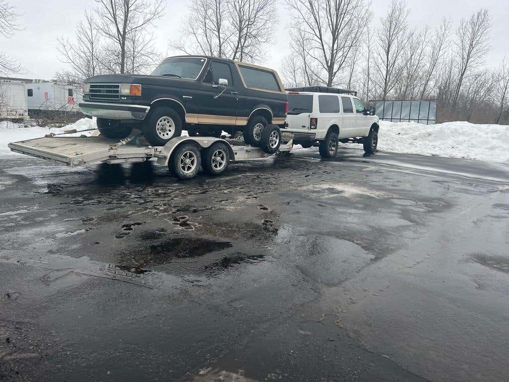

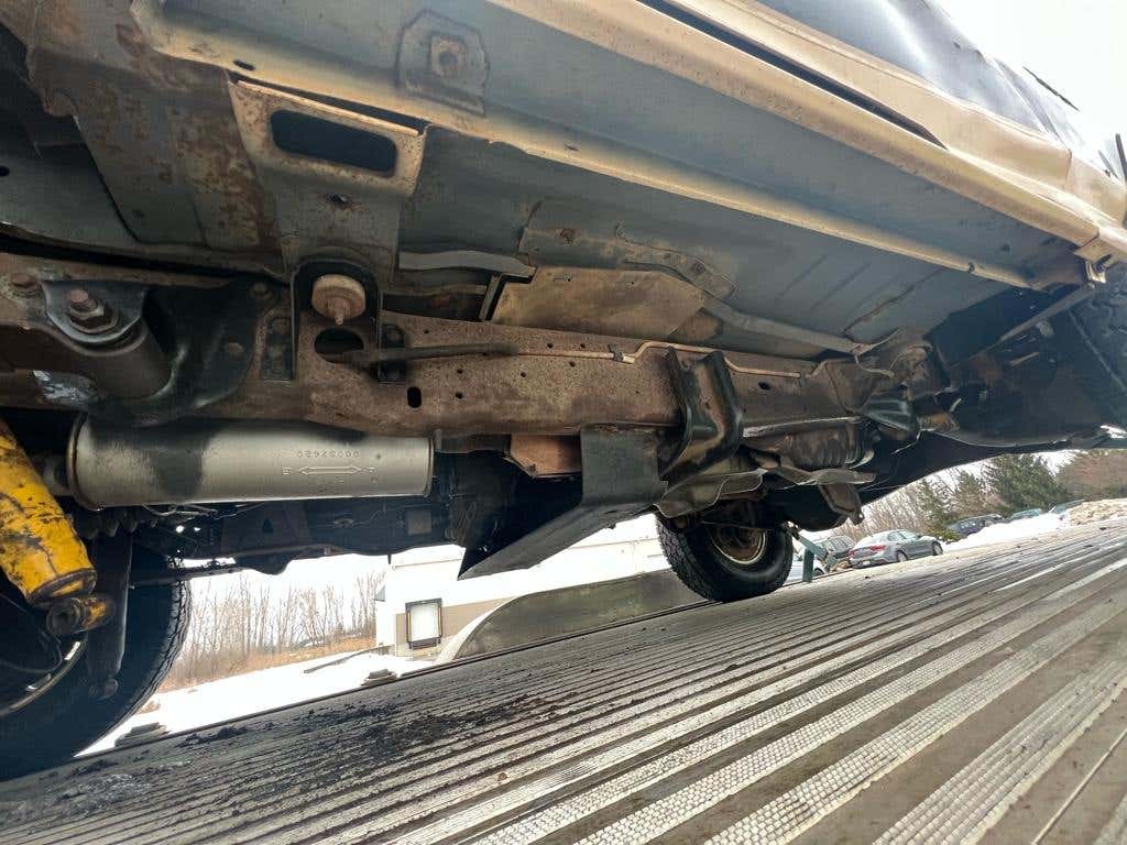

Just had this delivered yesterday 2-12-22 from southern Tennessee to michigan. The first thing I did was wash the salt off it from its ride up here. Now I start planning out my build. Plan so far is McNeil racing glass and dash Holley efi and going to a built 460. Going to buy extended beams 12” coil overs and cage it. I’m undecided about the rear right now. I keep telling my self just keep it simple with leafs but I also want to just link it lol. As far as shocks go I’m going with Carbon Shocks 3.0 coil over front and 3.0 triple bypass rear. I would like to add a set of twin turbos once I have it up and running which is why I’m going with the Holley terminator x. That’s all for now I will try to keep this updated as I get parts
