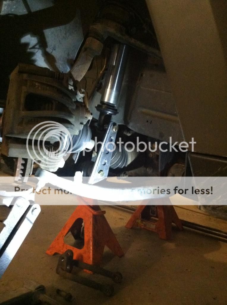

Now, on to the front. Since the Liberty has upper and lower control arms with a strut, putting a coilover in should be pretty easy. I'll let the pictures do the talking.
Top mount:
Bottom mount, had to get creative because of the axle shaft:
Packaging wise, everything fits great. Super easy install once all the brackets were made.

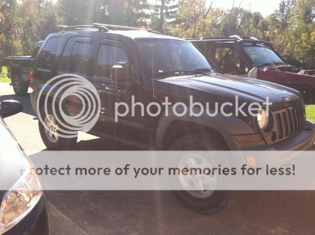

Back to the build, I found a great deal on some GoodYear Duratracs. 265/75r16s. Mounted on the stock wheels.
And here is the finished product.
