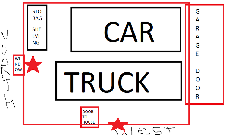

This is the heater I bought
http://www.ruralking.com/mr-heater-3...fr30tb-lp.html
The 2 places I can put it are the North star and west star, my thought is north star since there wont be the side of a truck blocking the heat. Is my thinking correct, or is there a reason I should put it on the side of the garage(west star) instead of the front of the Garage.

North will give more even heat, is there room to put it by the garage door? I know someone with it set up like that and it seems to keep the garage warmer, especially if you have to leave the door open for running a vehicle inside the garage.

I Though about doing that, but have no access to above my breezeway. I have a 750 sq ft house with a furnace that overkill, thought it would at least help keep it warm and shouldn't use much more propane.
Not really, 2 spots I starred are about it.

Bummer. The downside to the north wall is with the door open, you are essentially blowing all your heat out the door.

Personally i would put in a hanging vented garage heater. Yes they are more $ but it will be properly vented and heat the whole garage. The ventless heaters eventually fill the space with exhaust and moisture leaving everything covered in rust. I know from experience.
http://www.northerntool.com/shop/too...7749_200577749
This one is only a couple hundred more and will do the job better and safer. Minimal piping required.

You do not want that type of heater in your garage..hanging heaters are ok if you get a sealed combustion.the cheap ones still draw from garage.reznor makes a nice unit .so does moodiness.and sterling. And then hang in northwest corner aming to the southeast,,that said look into a sealed unit.and code is no flame less than 28" from floor(would want to check that but it's some were close to that

Already ordered, if it doesn't work well Im only out $200, plus I could sell it used for probably $100. Co-worker I have loves his, and the one in his last house.

Isn't forced air heat really expensive to operate, especially since I am on propane.
