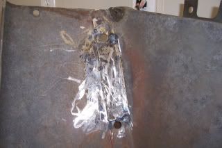

so far the rear axle has been stripped treated, primed and painted. new stainless cover bolts, new rear driver wheel cylinder and new bent rear brakeline with stainless retainer clamps.
I have removed all the windshield bracketry, trans covers, boot rings, rear bumpstop blocks, rear floor mount which were all cleaned in the electrolysis tank, then cleaned, primed and painted. no old bolts are being used so I got all new stainless fasteners for the items removed. anything for the frame like the rear crossmember bolts are being replaced with grade 8 units.
windshield after all 53 drilled holes from whatever were welded closed and ground smooth before paint removal.
some after shots of the windshield frame

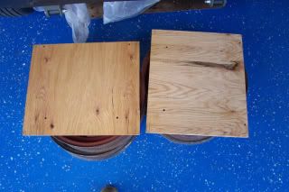

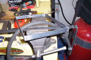

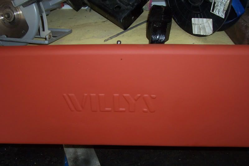

got some more progress done but not as much as I would have liked. made the tie in plate from the v-brace to the crossmember. then removed both for prime and painting. removed the muffler to get at the frame in the rear and start the rust removal. some pitting and weld marks but nothing serious. unfortunately I have to do the frame in sections and don't have the room to separate the body so the top of the frame or interference areas will have to wait until I can get at them better. took about 3 hours of working with various wire wheels, scotch brites and the like to get all the areas to the metal and then started the coating with the rust converter. I only took pix after the first coat but you get the idea. once dry I put on the OD chassis paint. it is a little lighter that the other OD I am using but am real happy with the two tone OD.
Pic of the driver front brake assembly:
The steering wheel:
I need a new nut but the wheel itself came out pretty nice.
Crossmember and plate:
First Coat of Rust converter:
OD Chassis Coat 1:

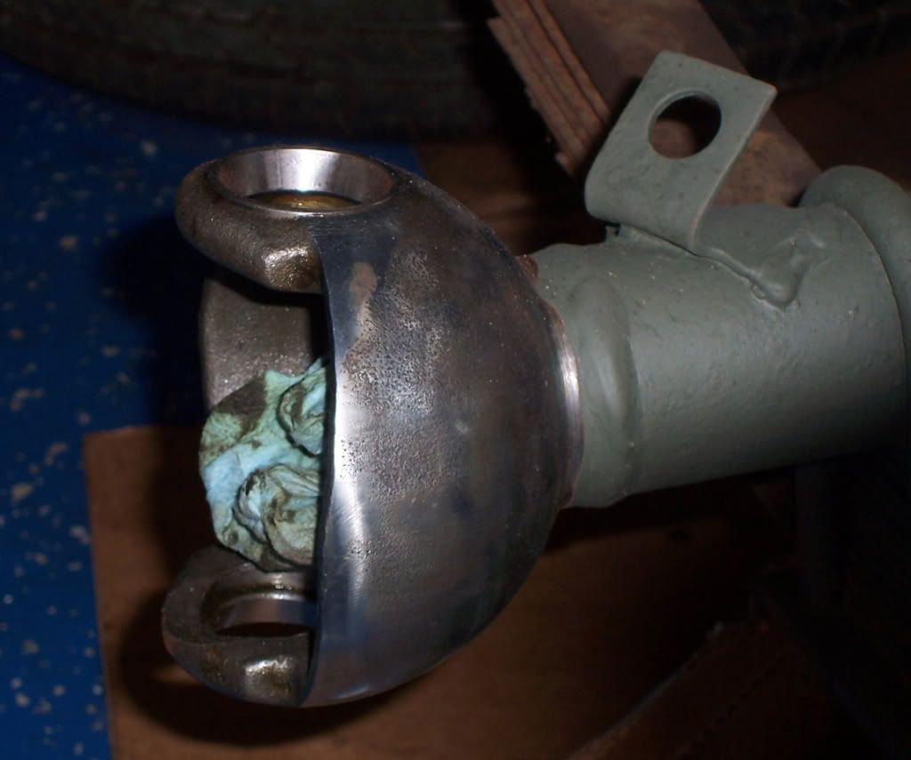

posting up some of the progress made on this build. it's going well and I just keep plugging along at it. photos are from middle of july to beginning of august.

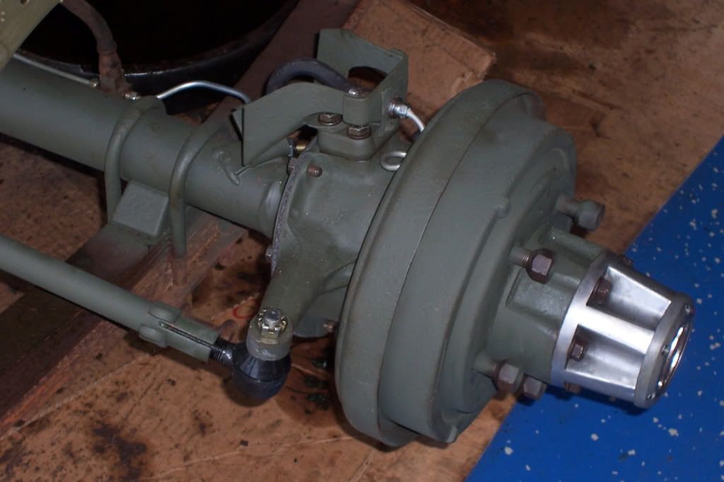

time to rebuild the front end. drained the fluid and pulled everything apart so it could be cleaned, stripped of rust if needed and repainted. I installed new inner seals, new kingpin bearing and races, new knuckle seals and front hub seals. wheel bearings were fine so I cleaned and repacked them. all new tie rod ends, remove and clean up bell crank and drag link. new wheel cylinders and new brake lines I made (including the "S" lines, which were a pain) LOL
patiently waiting parts
starting to go back together but waiting on the wheel cylinder I forgot to add on my parts order.
the refinished front cover with new stainless hardware
more parts waiting for their turn
shackles before painting
urethane bushing kit for the new shackles (thank's jeeperzcreeperz)

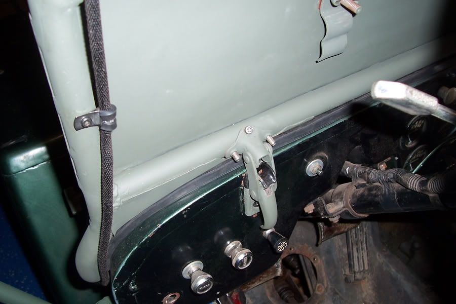

now working on mocking up the windshield. got a replacement inner frame from 4wd hardware. had a problem with the cowl mounts as I didn't have the 2a correct ones so ordered some and was back on track. I am using plexiglas for my mock up
pic of first install (shows the hood painted too)
currently setting up the the wipers and deciding on how to wire them.

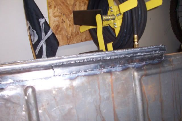

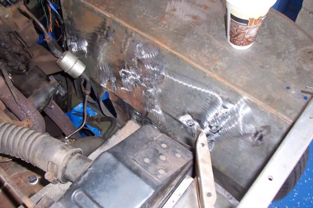

some spots on the front fenders with some rot that needs repairing.
Filling in all the holes on the driver fender.
removed portion of the lower inner driver fender where the rot was
both fenders are getting new supports installed as when they get here.
working on one side of the patch panel from above.
camera batteries died but I got all the driver patches installed and then rough ground down all the welds. also welded the 4 holes on the parking lights welded up.
right now the plan is finishing the bodywork on the front end and get everything test fit back together. fabricate a hold down for the battery. I am going to pull out all the wiring and replace it with a new replacement harness. also going to switch the externally regulated alternator currently on there with a 60 amp 10si one wire. also now is going to be the time to decide whether to rebuild/recore the existing radiator or buy a replacement since all is easily accessible/dismantled.
