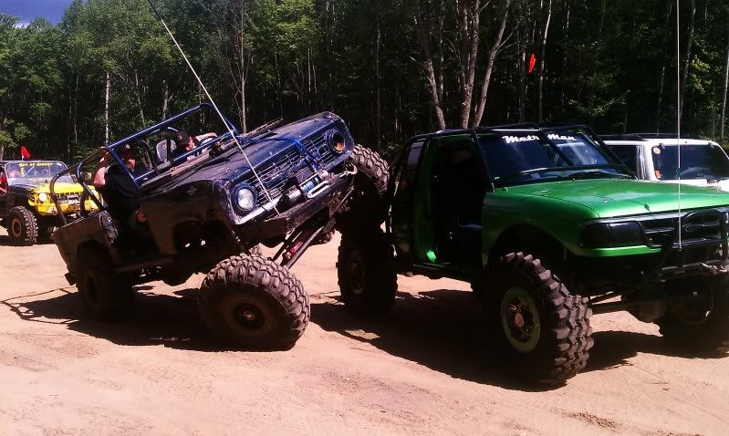

Originally Posted by Kyle M. View Post
John, I keep thinking your me looking at your avatar lol. I had that other pic as mine for a while.
Comparison...
Old
New
I see a trend lol.

Ya your rig keeps humping a ranger...
