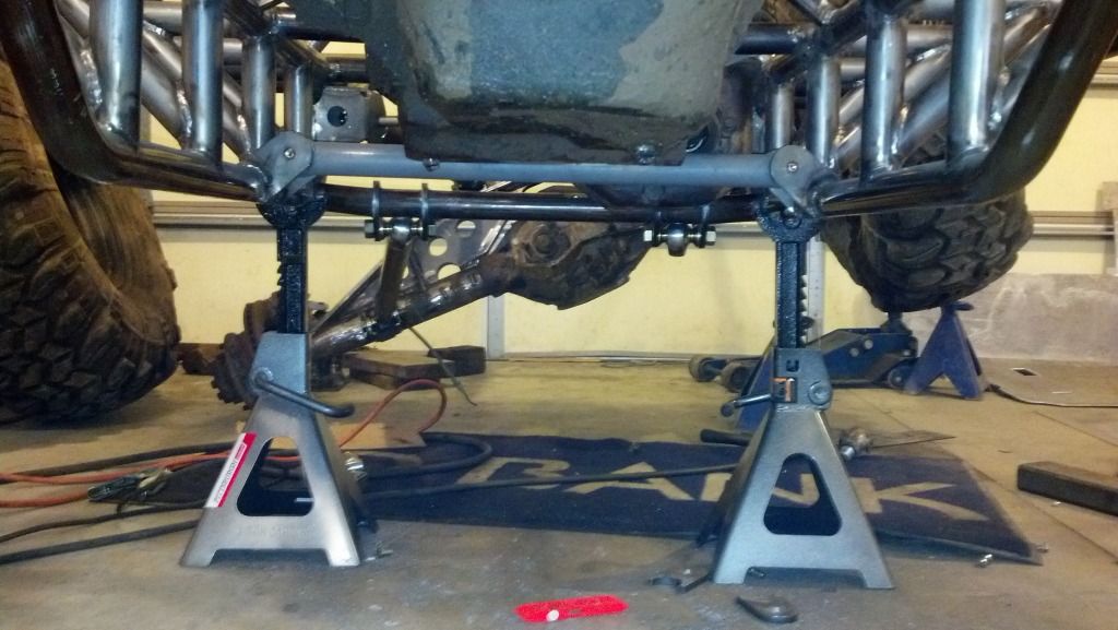

Playing more with the 4 link. Mostly just changed the lower chassis crossmember and mounting. Feels good flexing it all around on the jackstands. In any position I put the axle it doesn't wanna push the chassis around on the stands. I can bring it straight up till the truss touches the chassis and I can flex one tire up to the chassis and drop the other till the rotor hits the floor. More travel then what my suspension parts will handle. I ordered 16" travel for the rear.
