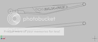

If you don't want to go with aluminum you could always just truss your lower links and mount your C/O's to the link itself.
Something like this:
But I'd probably keep the DOM straight and build the truss/mount down the full length of the tube.
