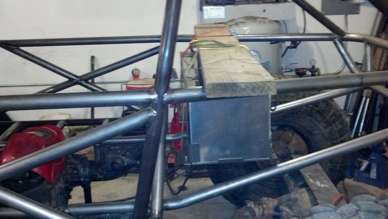

Thinking this is where my cell might end up.....thoughts?
Obviously mounted to the chassis not supported by straps and wood lol.

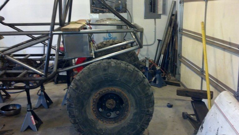

Old December 12th, 2012, 06:19 PM   #297
Posts: 35,299
iTrader: (66)
And I think this might be where I place the rear axle in the chassis, I lifted the chassis to where I want it to sit at ride height. I have just about 22" from the ground to the bottom of the chassis. With the rear axle there I should be real close to 36" long upper links.

How many gallons is that and how big is the "reserve"

Looks good.
Old December 12th, 2012, 06:22 PM   #300
Posts: 35,299
iTrader: (66)
Actually its the same size as the gas tank I was previously using, and I haven't run out of gas in quite a while Kyle has had more issues then I have as of late . I don't think I ever ran out of gas int he eb, truggy yeah.
