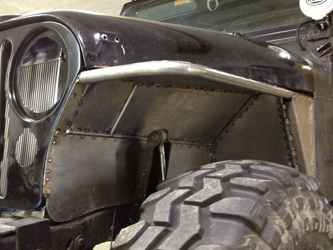

After I got everything back together I started working on building some bumpers. The main bumpers are 2x4x3/16. I started with the rear bumper first:
Used the plasma to burn the holes through both sides of the bumper for the receiver and shackle mounts so I could weld them on both sides for strength.
After I got the base of the rear bumper roughed in I started on the swing out. I used a 1” spindle and bearings. The material I used for the swing out is 2x2x3/16 as well. I also made the main part of the front bumper at this time.
When I replaced my rear cross member I used a piece of 2x4x1/4” square tubing so I did not have a way to mount the bumper in the original fashion. I made these mounts (4 of them) that are welded to the rear cross member and to the bumper.
After making sure everything was where I wanted it to be I started tack welding some things in place.
Made a mount for the Hi-Lift and put on the spare tire to see how it handled the weight. Everything went great. I even sat on the swingout after and swung back and forth. Definitely seems plenty strong.
Went and finished up the front bumper. Decided to add a hoop to protect the winch that I plan on getting shortly and also a place to mount the fairlead.
At this point I was in a huge rush to get everything together for a trip we had planned in Grayling during the winter. I mounted up a winch and added a set of Hella 500’s and headed north
Next update will be the Spring Over swap and pretty much end where the jeep sits currently.
