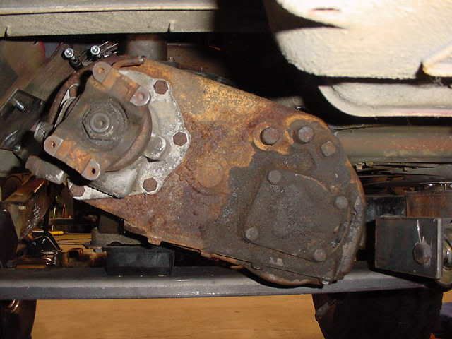

I got a chance to do a tummy tuck on it this weekend. I got rid of the big shovel for a cross member/skid plate. I needed a 2" body lift instead of a 1" to get a true flat belly skid but the tuck should do fine.
I clocked a redrilled the 300 t case to be above the cross member. I had to introduce to floor to a hammer to clear for the indexing, its under the seat so you can't see it.

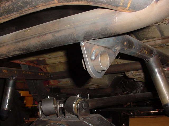

pic of the rear recovery shackle mount.
front recovery mount
