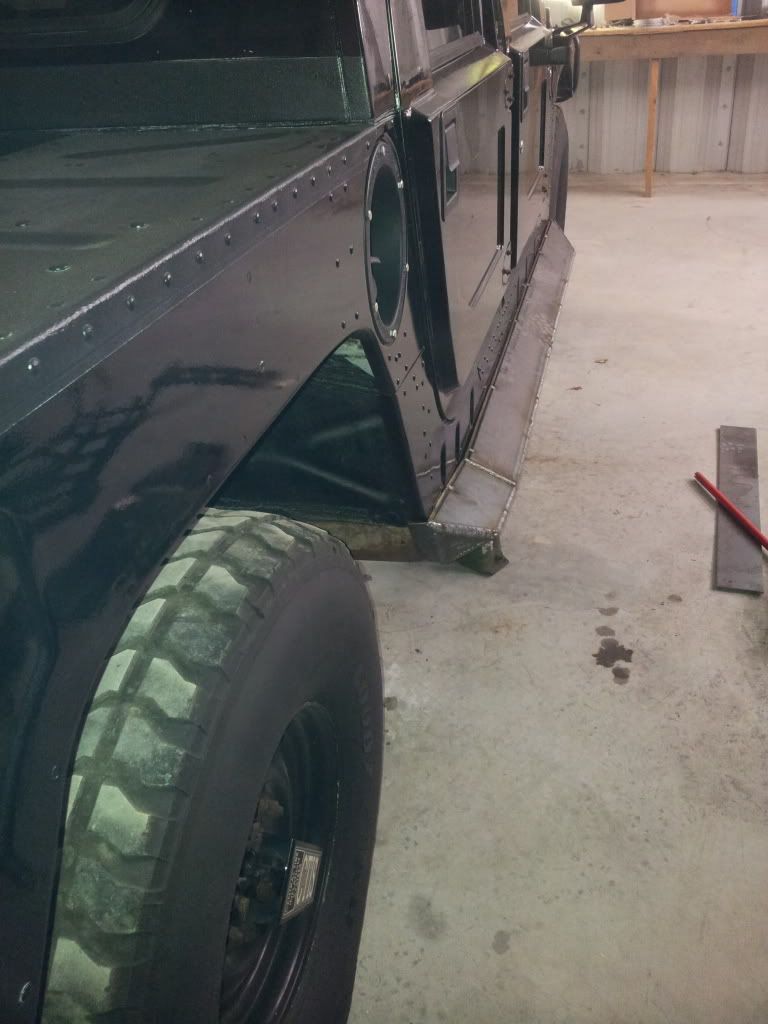

So, over the past few weeks I built some armor for the truck both the bed and the side rails under the truck.
The Hummer had the option of coming with a flat protector on it so I took some old ones (steel) and welded up some 1/4" to form sort of a trail edge that sticks out just as far as the mirrors do when they are folded in.
same on the back with the exception that I made one of the protectors have a door that locks to store a few things in... I am thinking that I will put my winch controller and a spiral air line in there.... nothing too expensive.... because it would not be too hard to pry that thing open.
