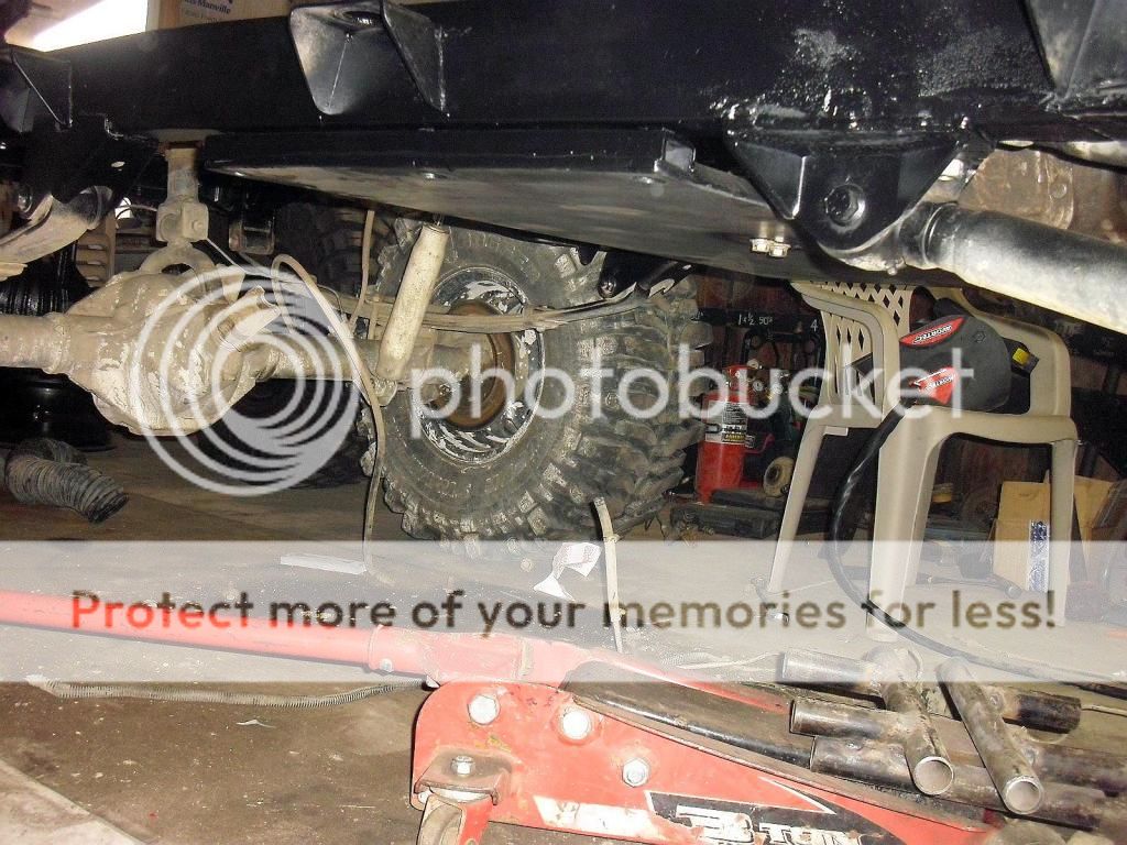

frame all cleaned up and painted in satan black with the crossmember/ skidplate i built out of 1x2 square tube 1/4" plate steel and 1/4" angle iron for support
here is the cross member i drilled the bottom holes bigger than the top and used allen head bolts so the bolt is recessed into the skid plate

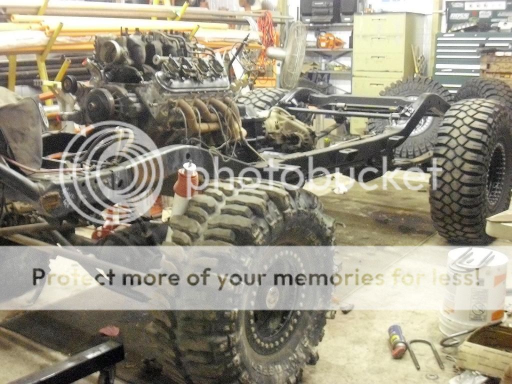

here i have the motor trans and t-case mounted and rear axle in along with 2 of the 40" creepy crawler with some diy beadlocks
then just last week i got the dana 60 bolted up trac bar made and all the small things buttoned up and rolled it out to paint the tub
