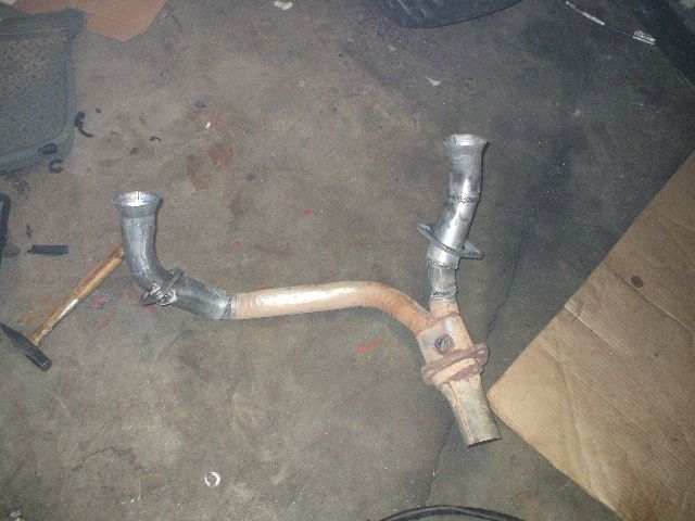

99% done now.
Fired up today and let it warm up. All fluids are good,charging system works,tach works,gauges work,65psi oil pressure idling,electric fan works and even the powersteering pump is quiet{thats a shocker for a Ford}.
Motor starts right up but has a slight miss to it which Im thinking is from a dead plug from all the dam fuel I was pumping thru it while firguring out the computer issues. Roller rockers might need a once over if fresh oil doesnt quiet them down a hair more. Or it could be from not having the O² sensors plugged in and Im using a 5.0 t-bird ecm right now which is calibrated for 14lb injectors instead of the 19lb injectors Im using with the Mustang ecm.Basicly is pig rich.
I cut up the factory 2.9 y-pipe and Brad over at Mytee made me some pipes to weld to it.Not pretty but worked perfect,nice and quiet.
STill need to clean up and loom a few wires over on drivers side,I was excited to just hear it run for a while.
