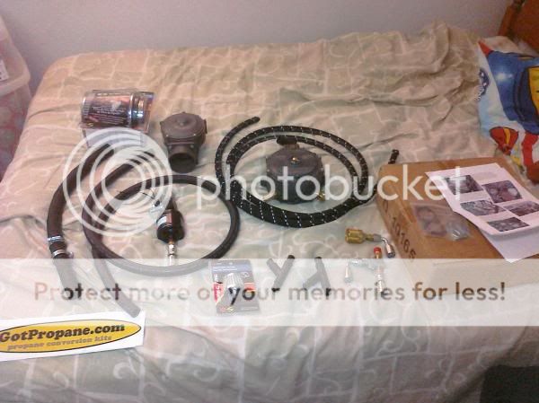

Here's the Propane injection install progression.
Everything that came in the kit.

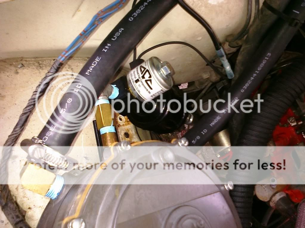

Regulator and Solenoid put together

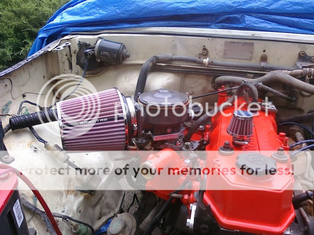

Here's the mixer installed on the old engine.
Mixer and feed tube from the regulator.
coolant pipes for the regulator. They tie into the heater hoses.
regulator installed in truck
Solenoid wired up.

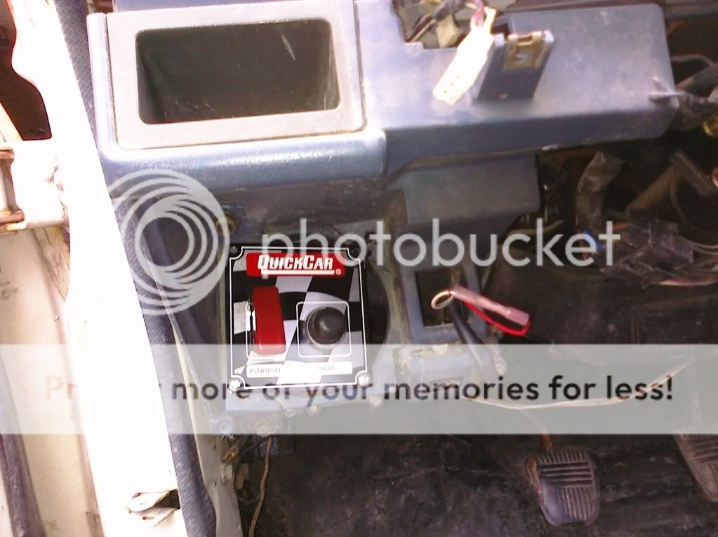

I have the ignition coil and the propane solenoid wired into this switch.

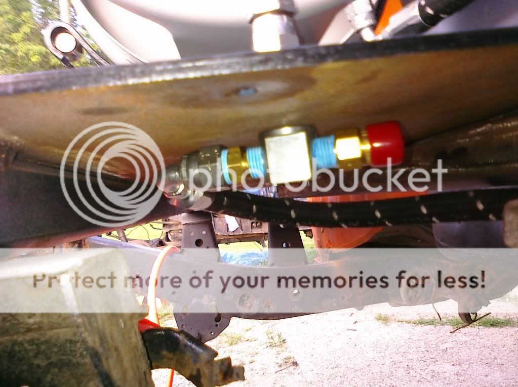

Here's the pressure regulator mounted underneath the tank.
tank mounted and fuel hoses ran.
