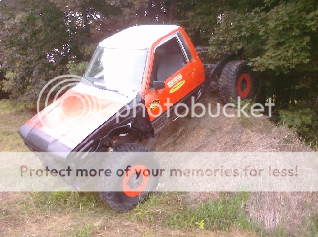

I have started this build a long time ago, and it is taking way too long to finish. I am aiming to have it completely finished before the end of January.
Here is what I'm running.
1987 Toyota Pickup
22R from an 84, running 'pane, headman header, deleted ALL emissions and computers.
W56 trans from an 84
Marlin Crawler doubler 2.28 gears in both
84 front axle, 4.10's, lock right, Dirty 30's, Hi Steer, trussed and blingin.
87 rear axle, welded spiders, 4.10's.
cut frame 6" behind cab
All Pro rear springs for a 98 taco(going up front)
Trail-Gear t-case crossmember.
35" BFG KM2's
15" Trail Ready Beadlocks
T Max 9000 winch
85:1 crawl ratio
I also recieved some 5 points for christmas so now we will roll safely.
Here's the front axle ready to go in.
Header
Safety First!!!
Prior to blowing up the first engine. yota 1.1.
'pane is the only way to burn!
I am going to upload a TON more pics. Enjoy...
