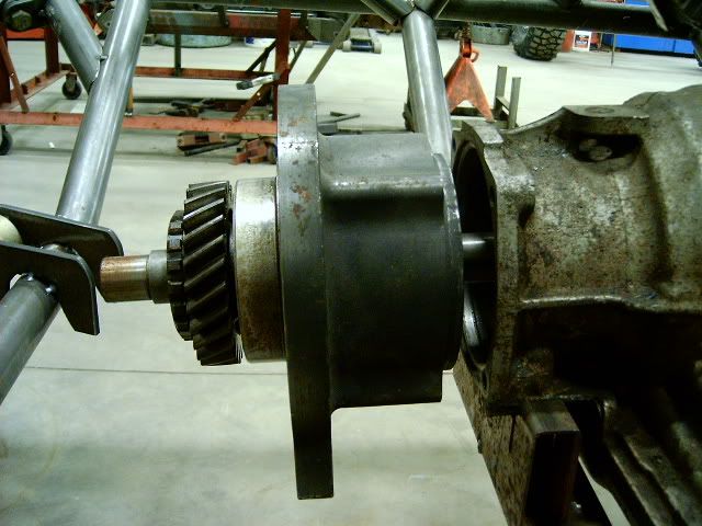

Adaptor: custom, drawn and cnc milled by me

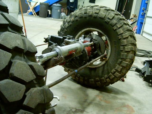

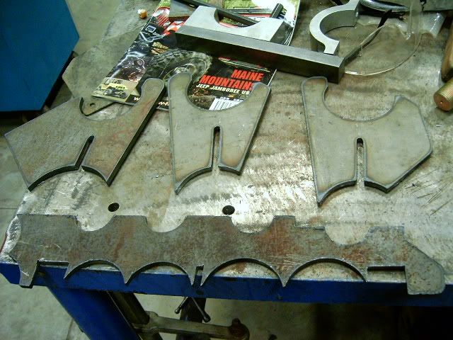

i am going to run a PSC steering, so i cut my self a bracket.
they slide together with the slots

The trans adaptor that i made.

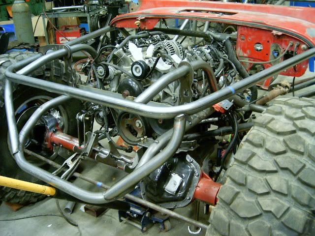

rear 4-link and shock mounts
ride height..
