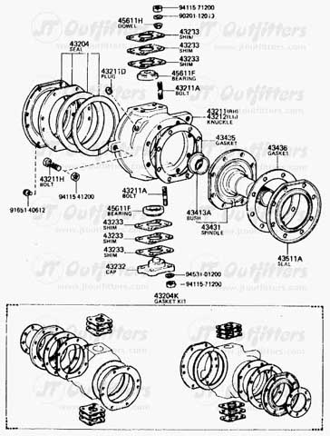

Figured we needed some toyota axle info :)
Axle Id
Toyota 4x4 Front solid axles
-6 lug 6 on 5.5"
-8" ring gear
-Removable center section(3rd member)
-30 Spline front shafts, they neck down to 27 spline into the birfields
-birfields, basically an early version of a CV shaft. Designed not to bind like Ujionts do when driving in 4x4.
-Trunion/Kingpin/Knuckle, no ball joints.
-Stock Aisin Locking hubs are very stout, usually only replaced for drive flanges.

Stock Toyota front axle measurements for comparison:
55.5" wide, 29" spring perch centers, '79-85 Toyota trucks and 4runners, SA Hubs
58.25" wide, 29" spring perch centers, '79-85 Toyota trucks and 4runners, IFS Hubs
63.5" wide, (set up for coil springs) 90-97 FJ80 and FZJ80 Landcruisers
'86-95 IFS front end is about 58.5" wide
